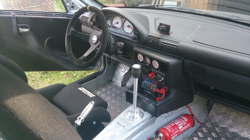

Postby samdemange » Mon May 09, 2016 6:25 pm

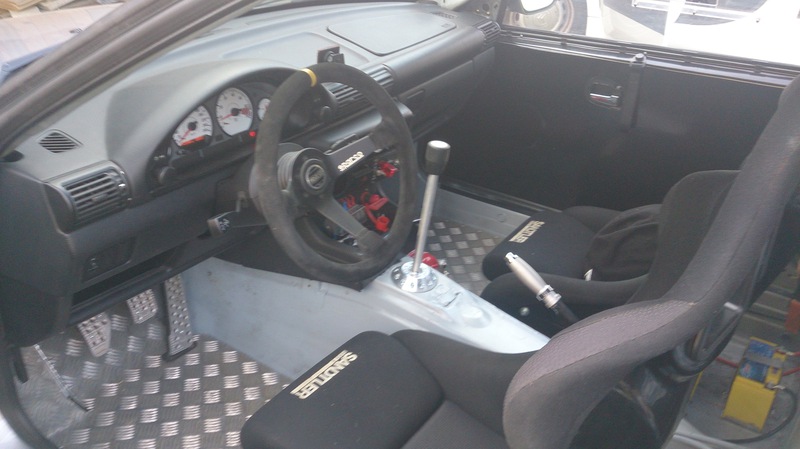

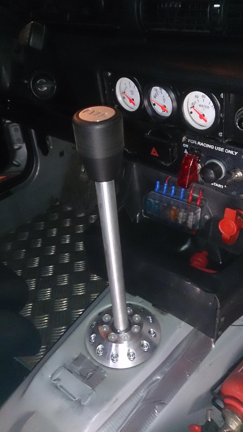

new joystick

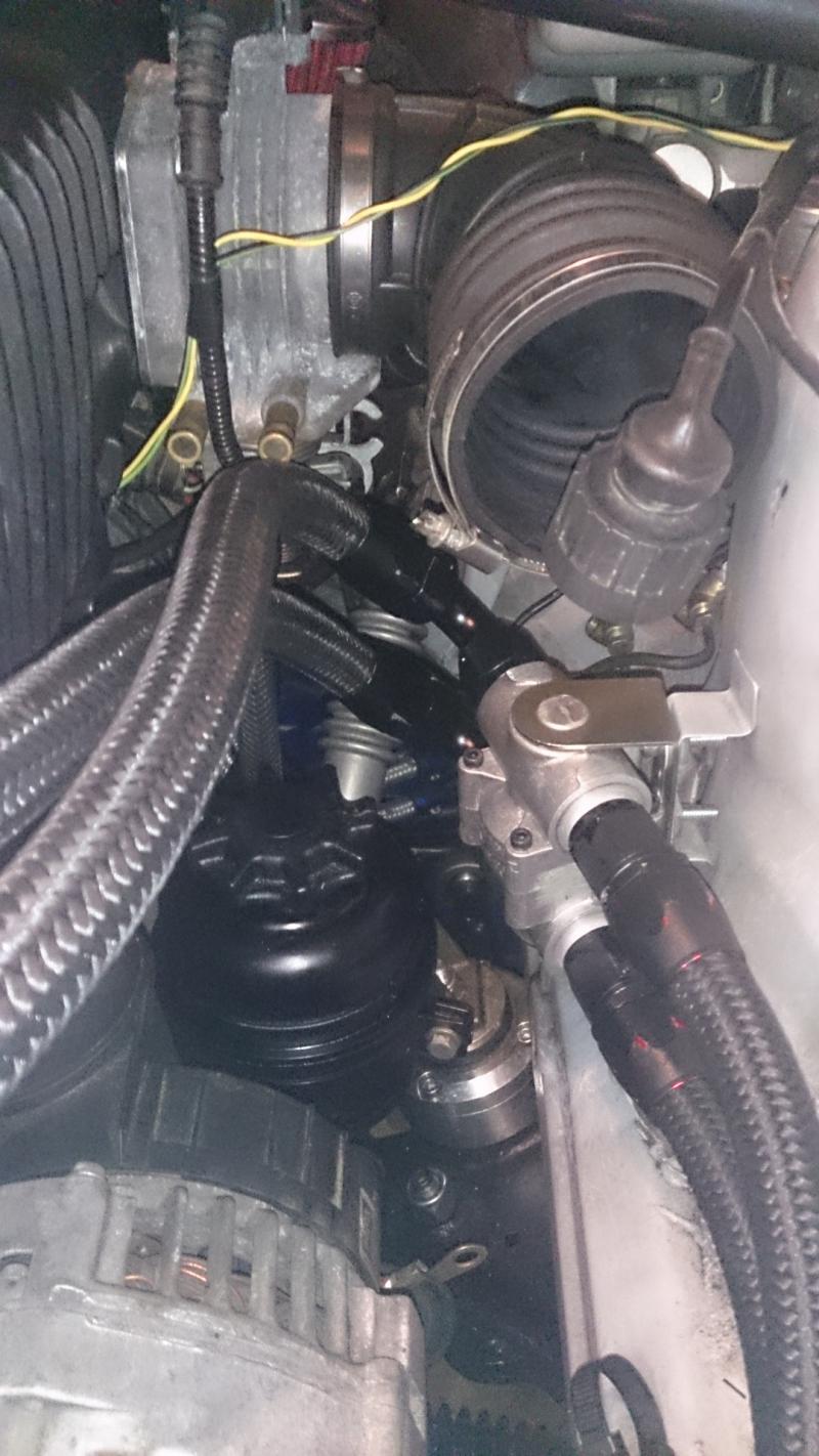

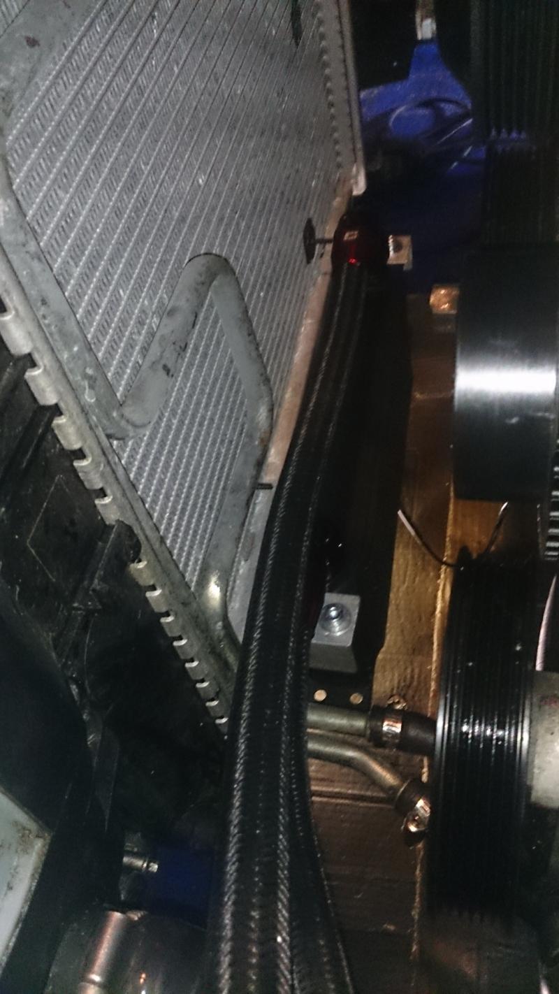

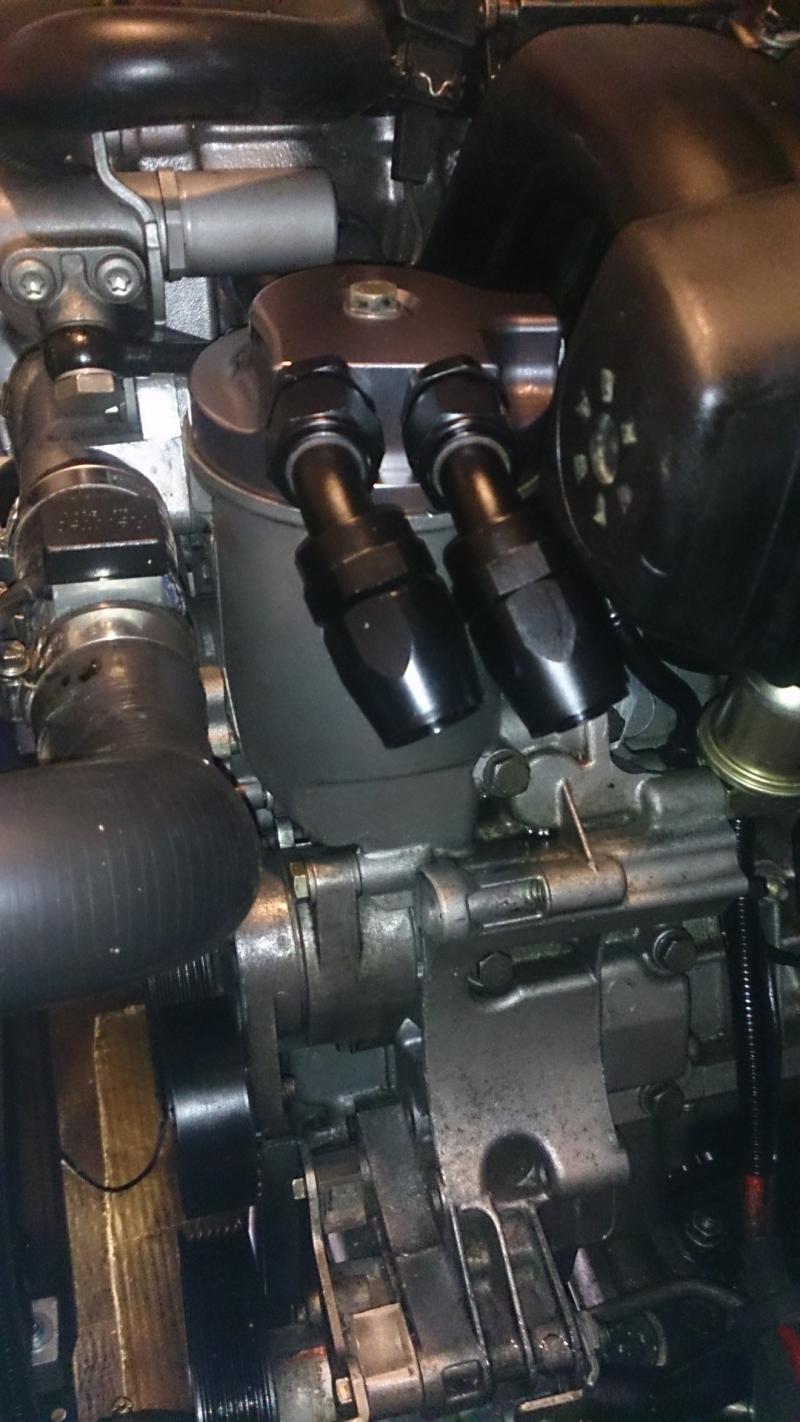

Postby samdemange » Sat Jun 11, 2016 9:59 am

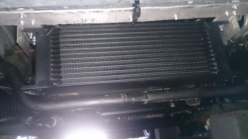

too hot for the engine oil this summer
doing a little job for this problem
changing the bloc to fit the new caps because mine is Ph2 ( plastic screw cover caps )
95°c thermostat at the canister place
and under the water cooler
try it yesterday evening,no leaks,T° decrease 120° to 105° and keep my pressure :D

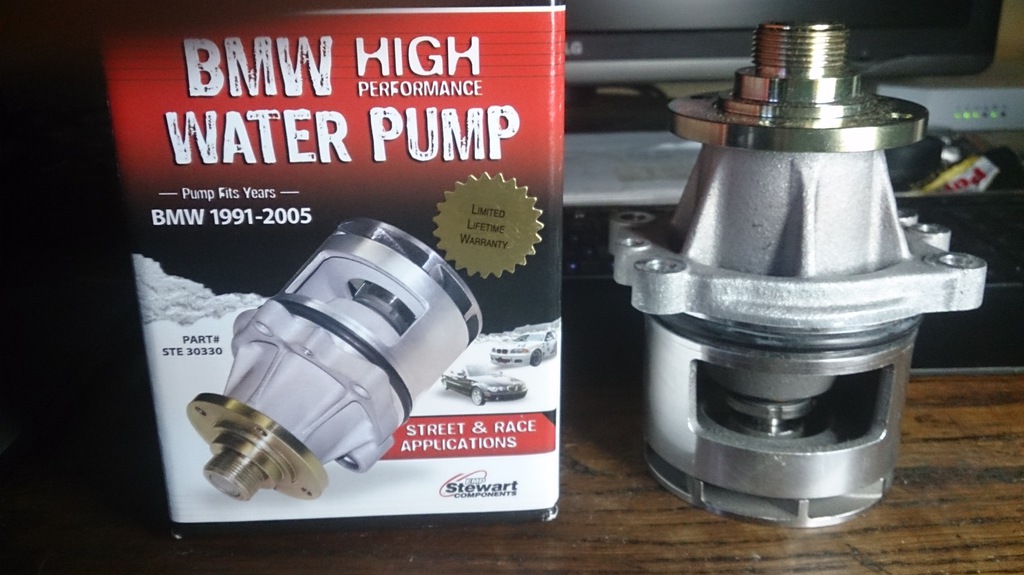

Postby samdemange » Thu Jun 30, 2016 10:31 pm
new heavy duty water pump,for changing mine ,because the bearing became squeaky after 1500 km of racing track :oops:

Postby mike » Wed Nov 02, 2016 12:32 pm
Looks good, where did you get the gear leaver from?
mike
Posts: 54
Joined: Fri Jan 18, 2008 3:39 pm
Location: jersey (channel islands)
Re: 328 ti trackdays
Postby samdemange » Thu Nov 17, 2016 9:20 pm
thanks you
sorry for my late answer
i have bought it here
http://www.cyl6.com/index.php?id_produc ... &id_lang=2

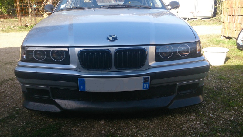

Postby samdemange » Mon Sep 04, 2017 3:02 pm

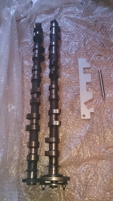

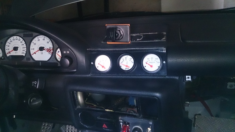

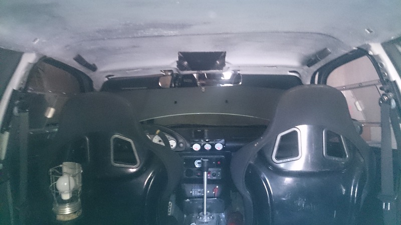

hi there,few summer update
new headlight
new gauges location
new panoramic mirror
and last but not least new camshaft (M54B30 int,M50B25 NV int )
