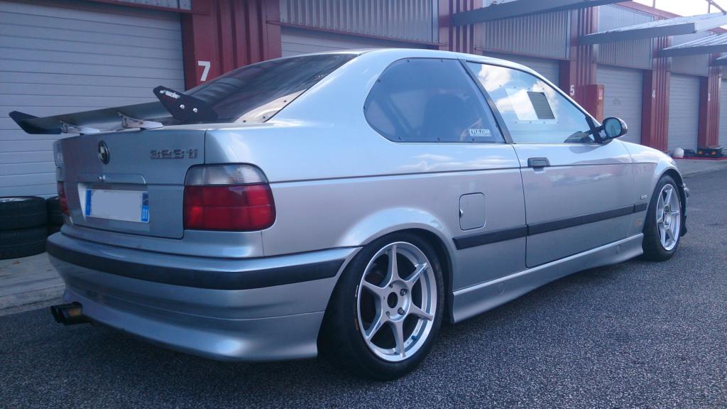

328 ti trackdays
Re: 328 ti trackdays

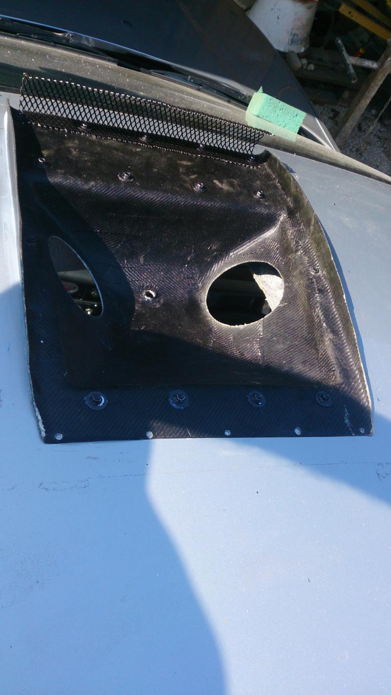

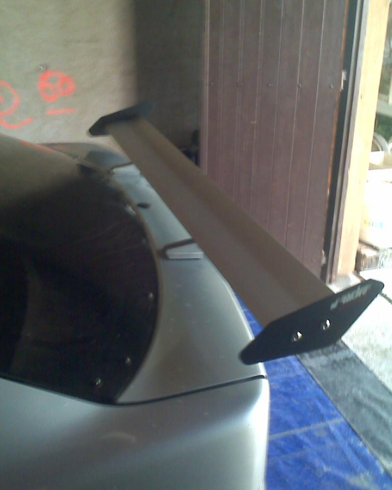

Postby samdemange » Sun Feb 14, 2016 1:34 pm

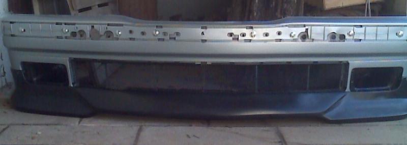

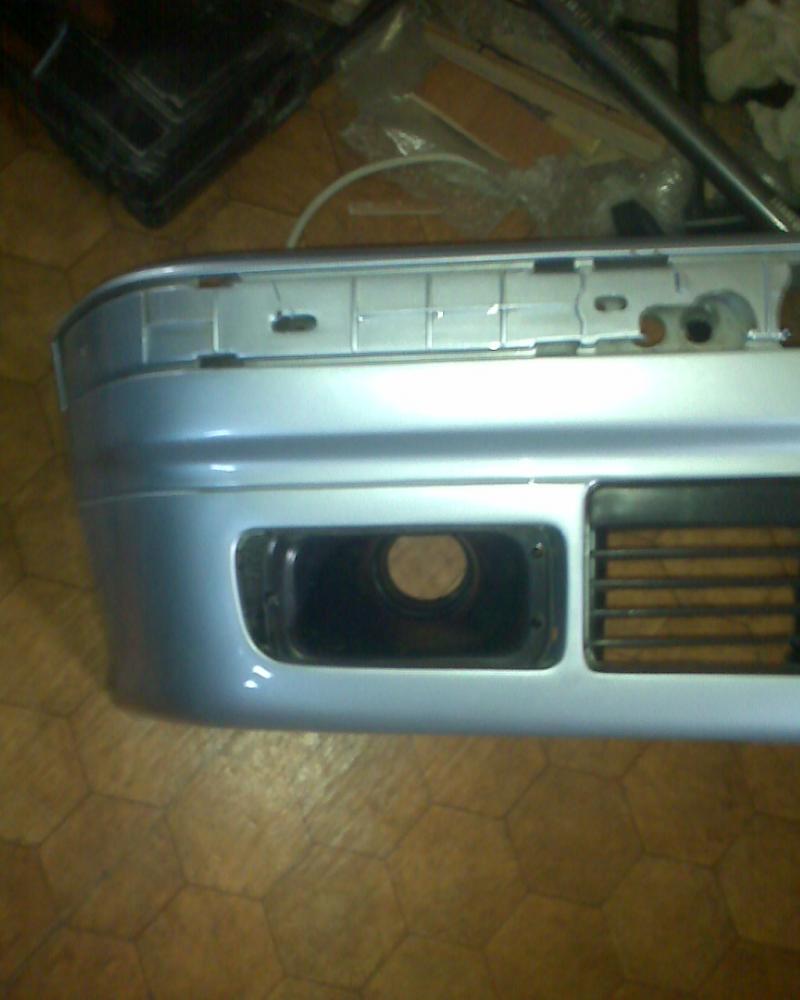

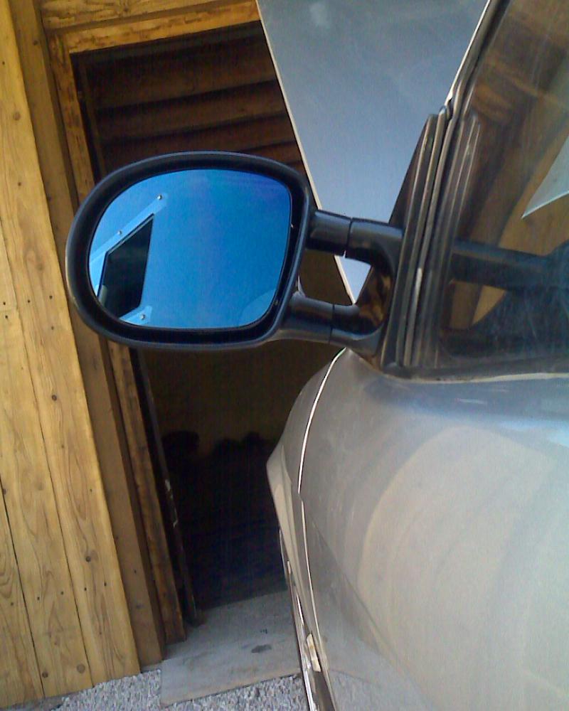

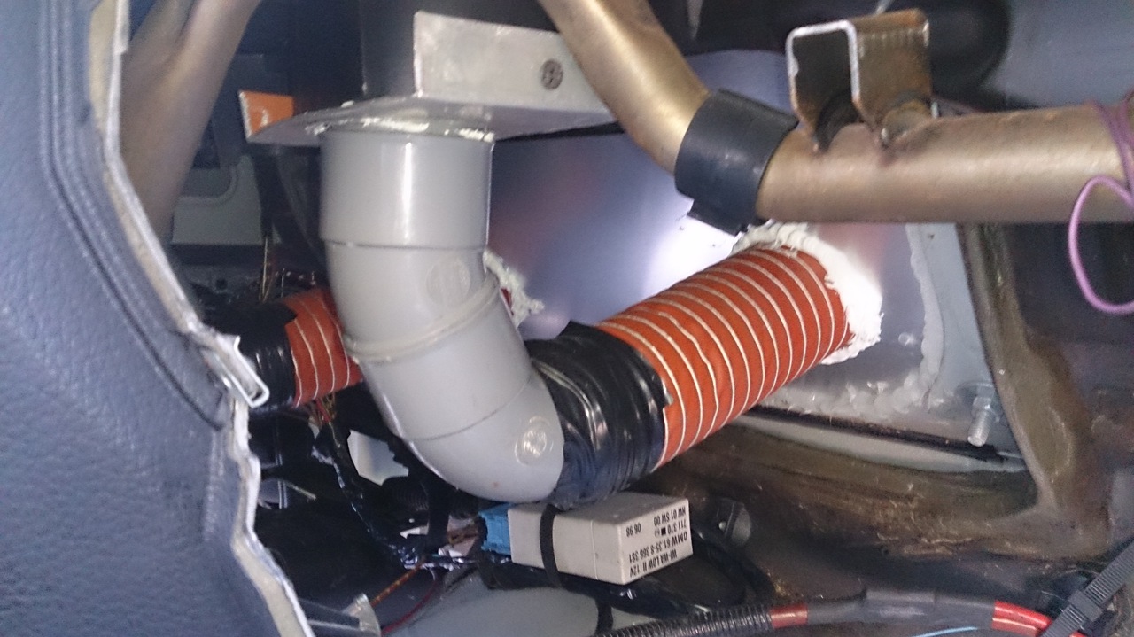

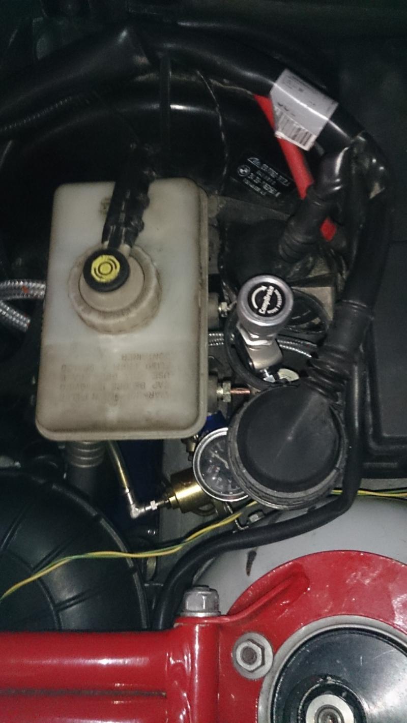

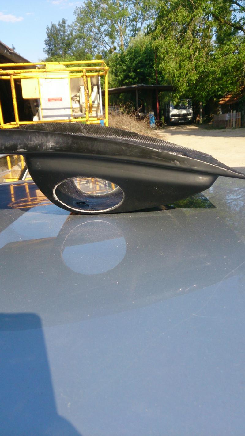

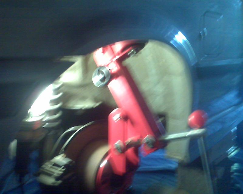

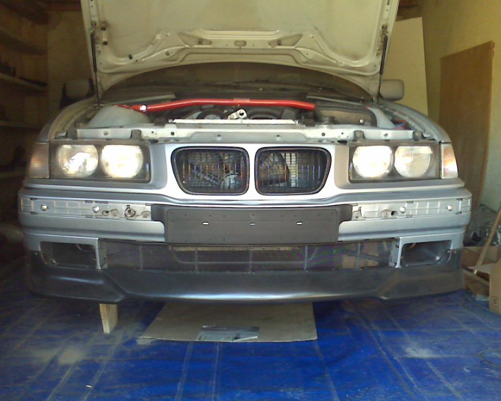

air duct for the brakes
add HP make you faster in straight line
lose weight make you faster every where

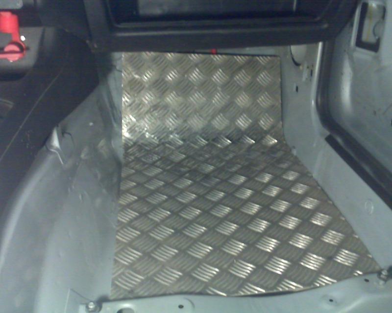

Postby samdemange » Sun Feb 14, 2016 1:43 pm

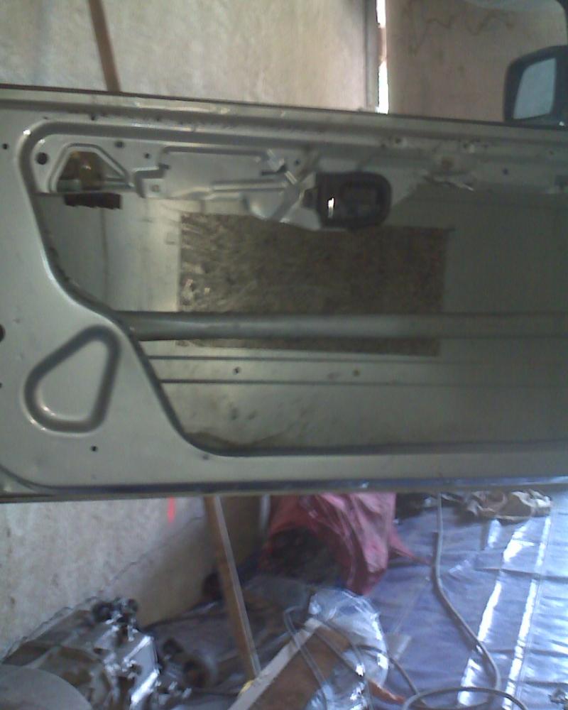

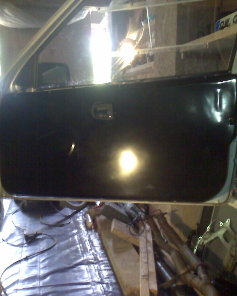

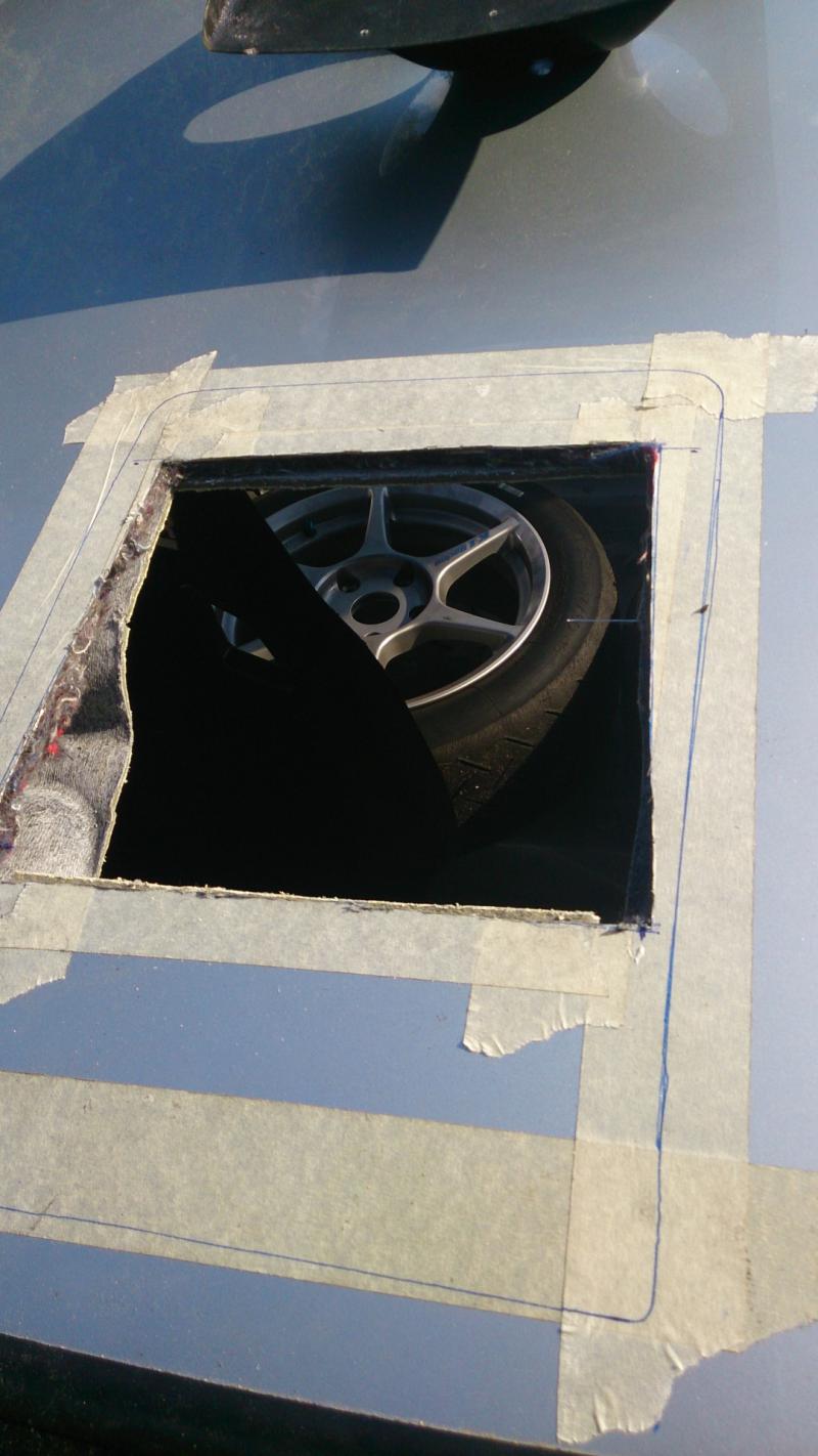

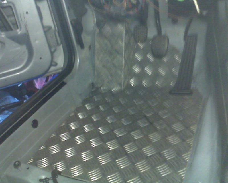

alu flormat
loosing some weight

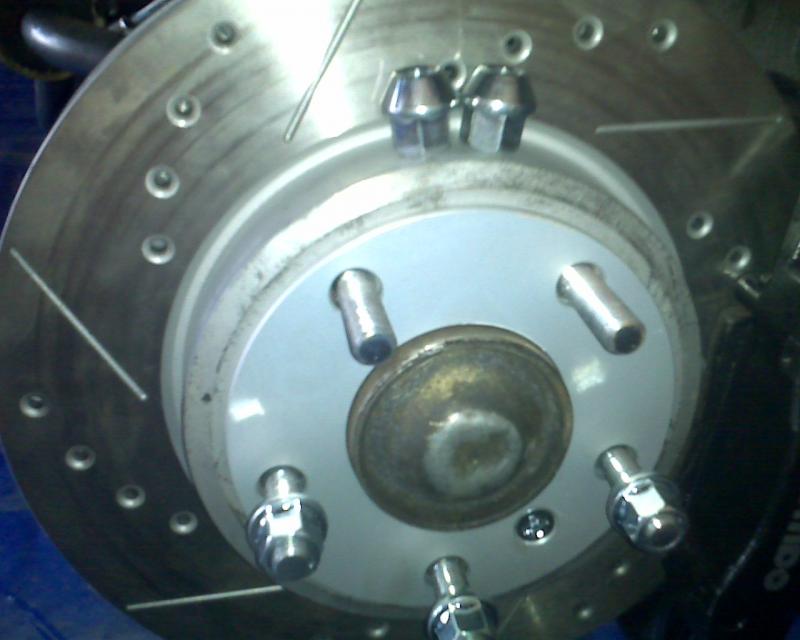

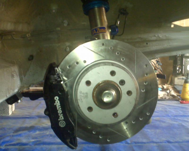

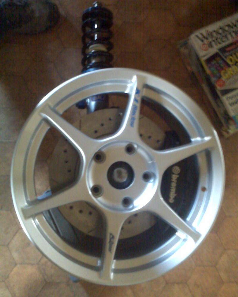

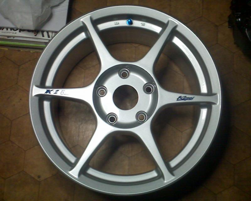

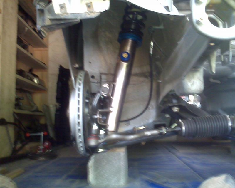

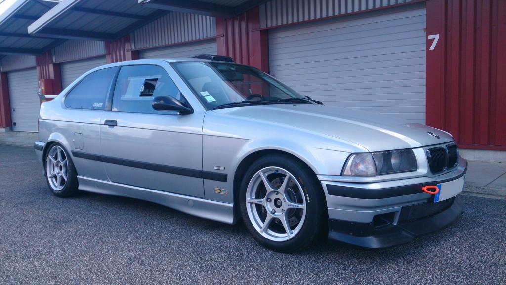

new wheels
kosei k1 racing 16X7
brakes just fit

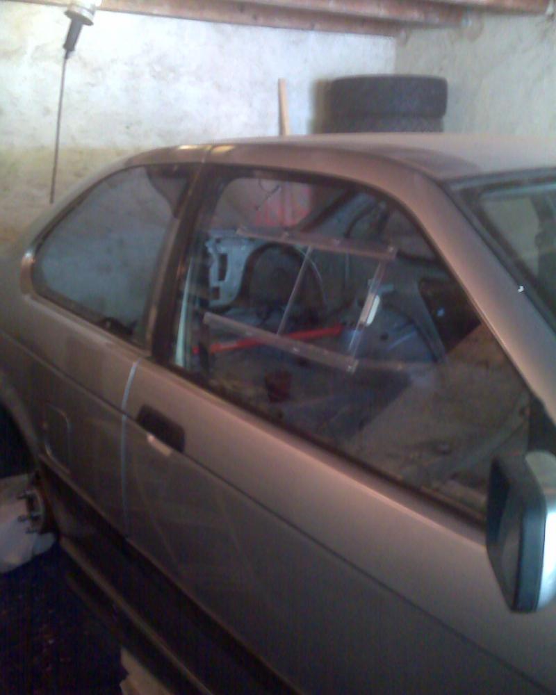

Postby samdemange » Sun Feb 14, 2016 1:53 pm

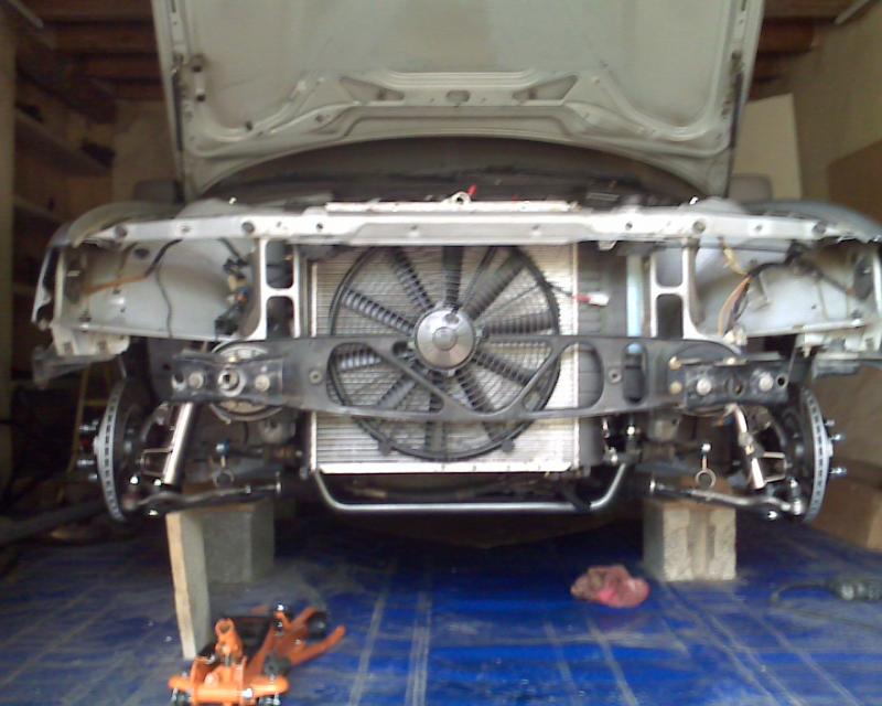

time to rebuild

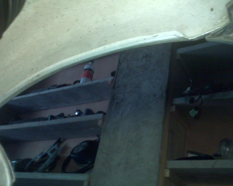

roller fender to the rear
now i know why the rear of the car has repainted

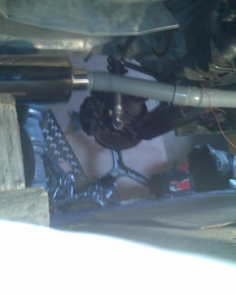

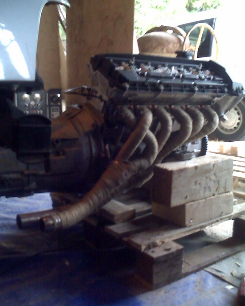

Postby samdemange » Fri Feb 19, 2016 8:50 pm

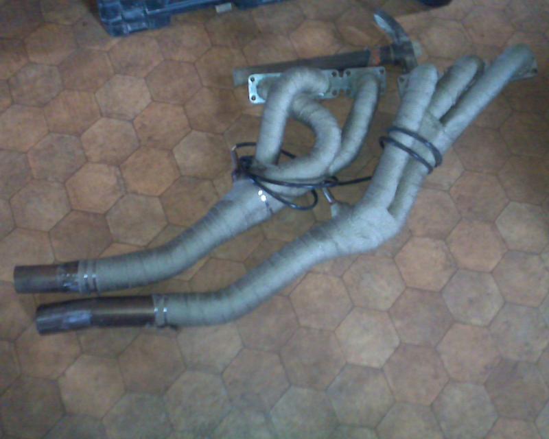

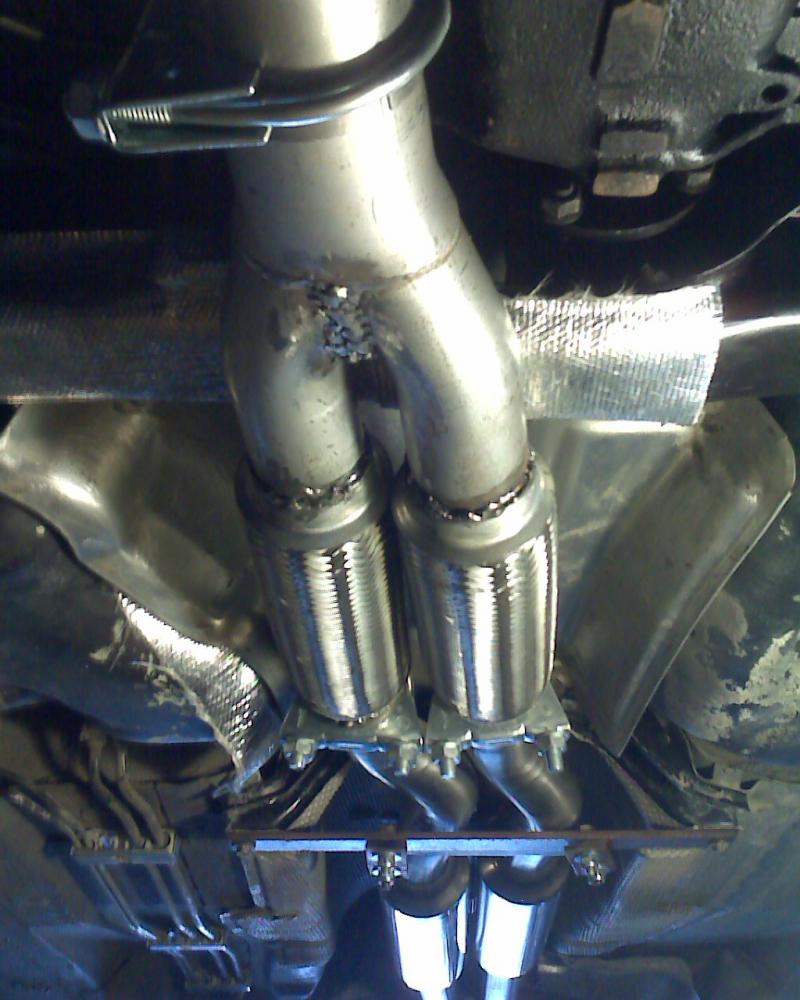

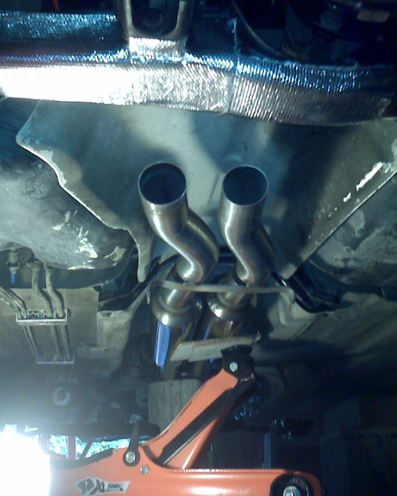

thermal on the header
PVC tube and wood for helping to find length and angles for the exhaust pipes

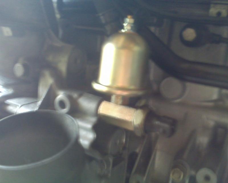

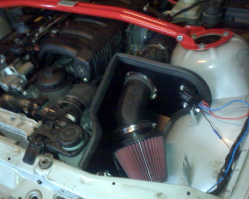

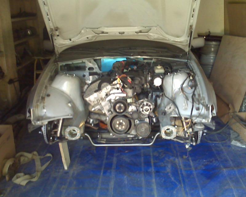

Postby samdemange » Fri Feb 19, 2016 8:54 pm

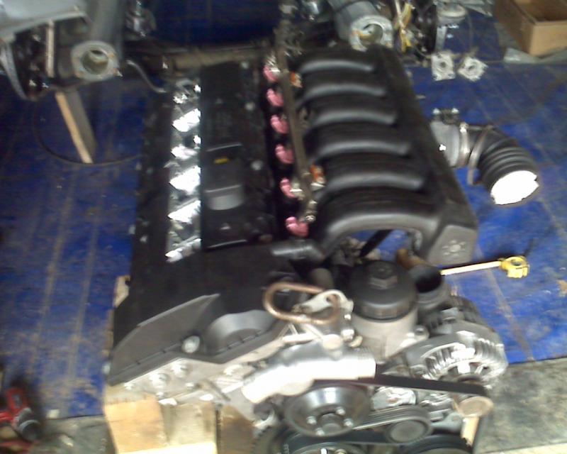

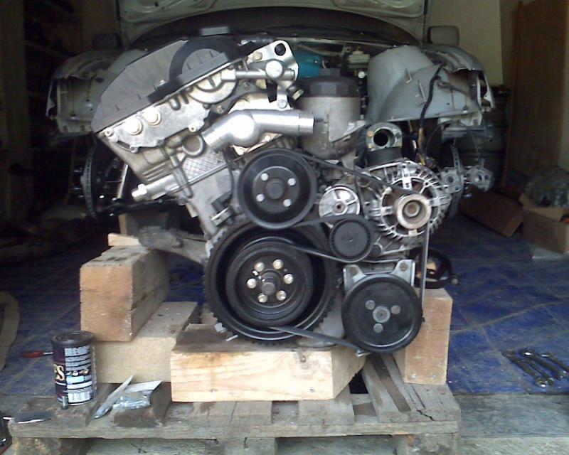

engine came from the mechanics (M52B28 )
time to rebuit

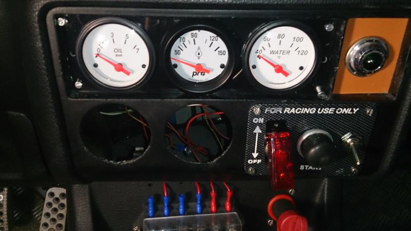

pressure+ oil temp

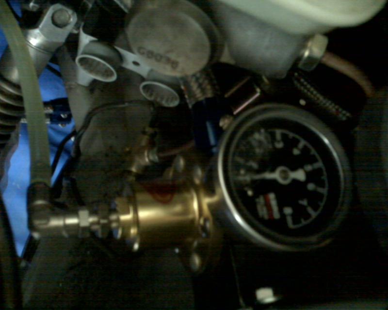

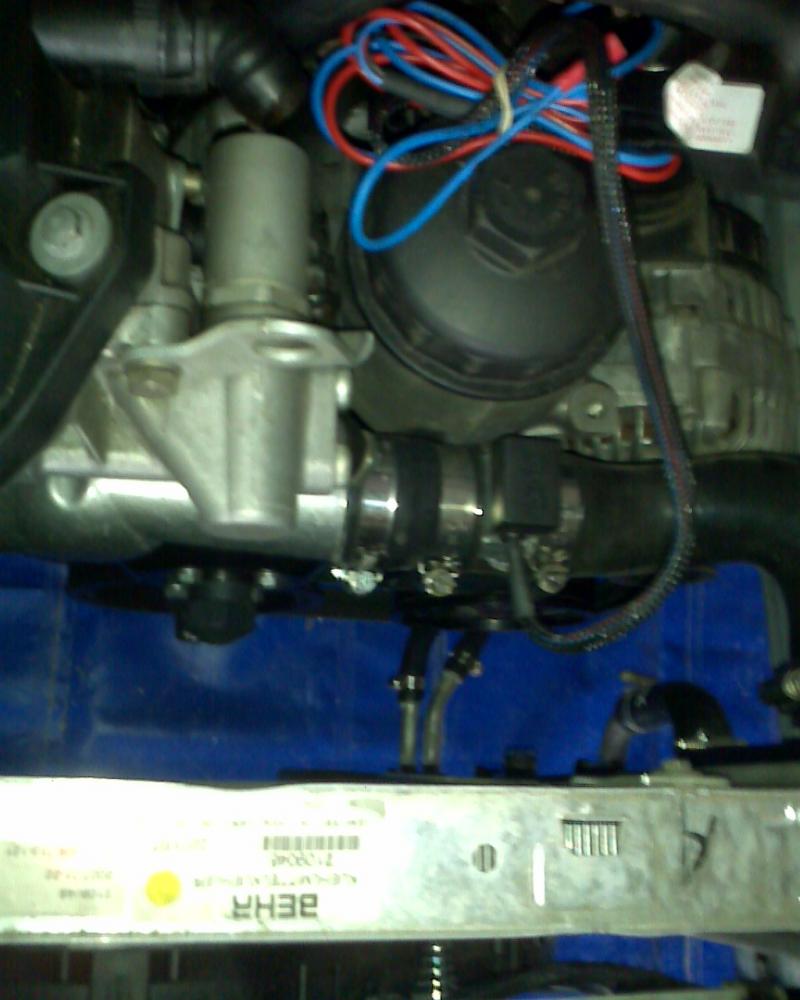

Postby samdemange » Fri Feb 19, 2016 8:59 pm

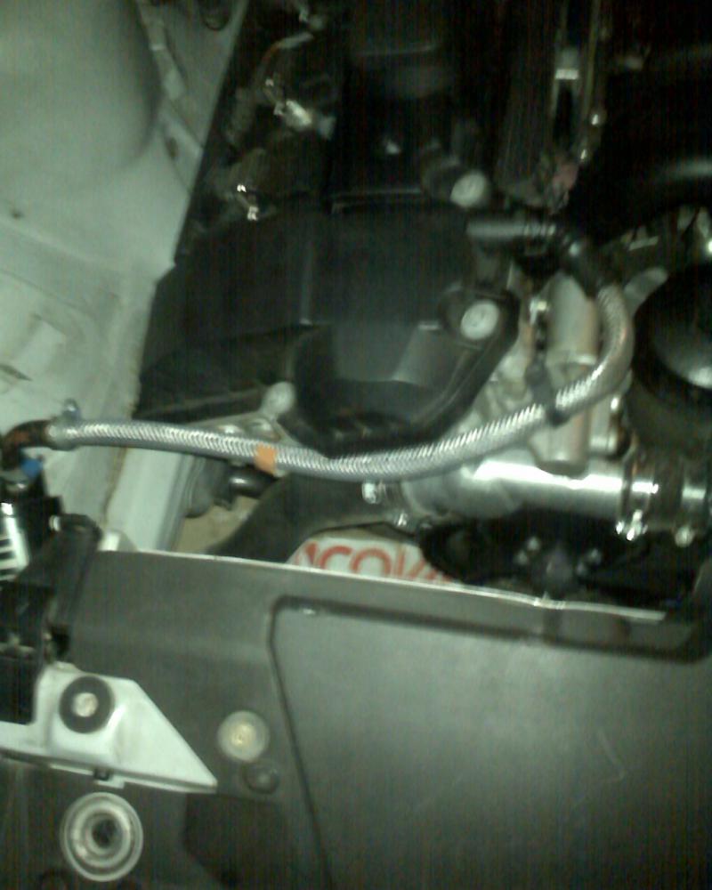

at is right place
fuel regulator on
radiator + spal

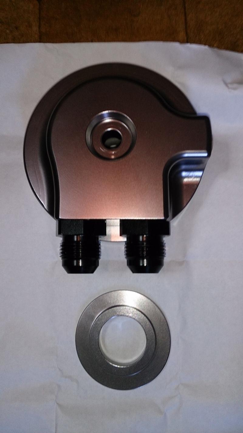

KAD
first time out since 14 month

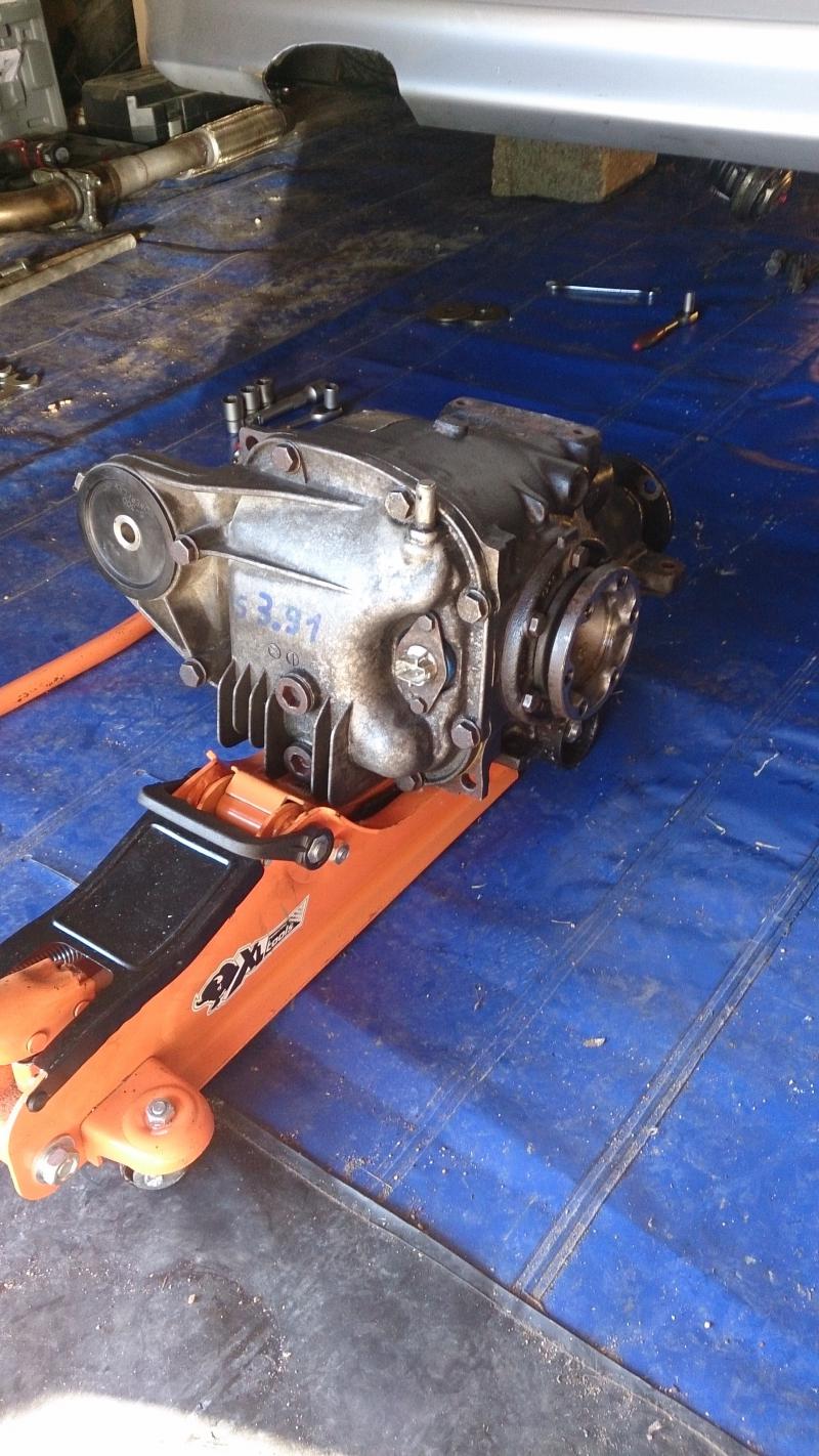

Postby samdemange » Tue Feb 23, 2016 1:00 am

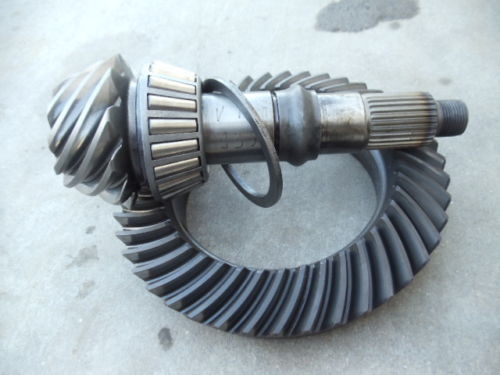

3.73 is little long for the track found a 3.91
adjustable limiter knob for the rear breaks

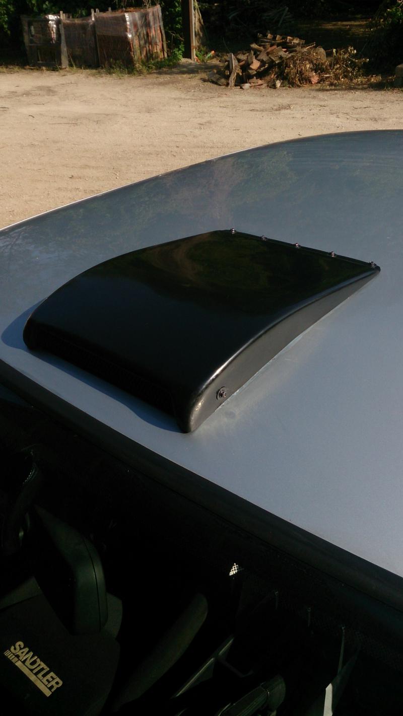

Postby samdemange » Tue Feb 23, 2016 9:17 pm

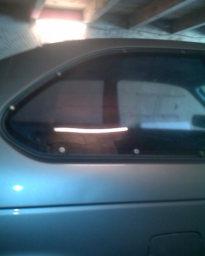

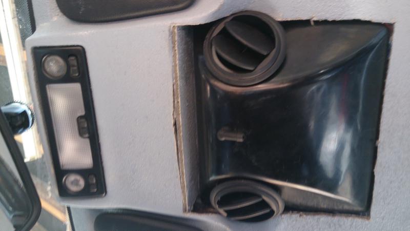

too hot inside this summer

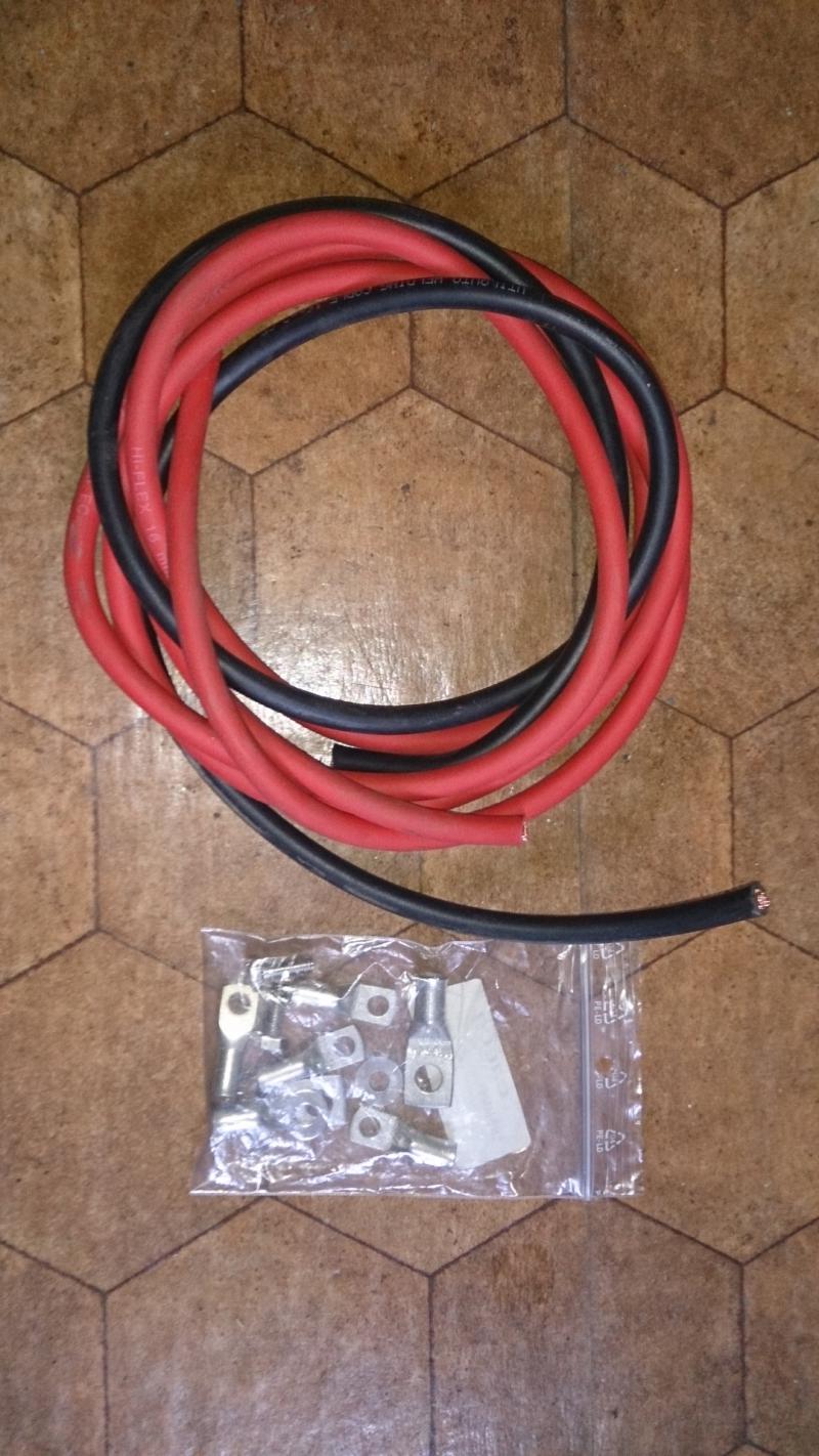

Postby samdemange » Tue Feb 23, 2016 9:22 pm

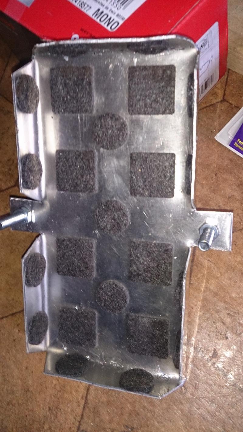

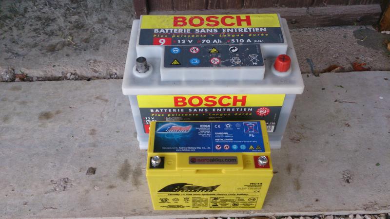

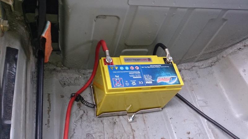

14Ah battery (5 kg instead of 17 oem )
3mm aluminum for the support

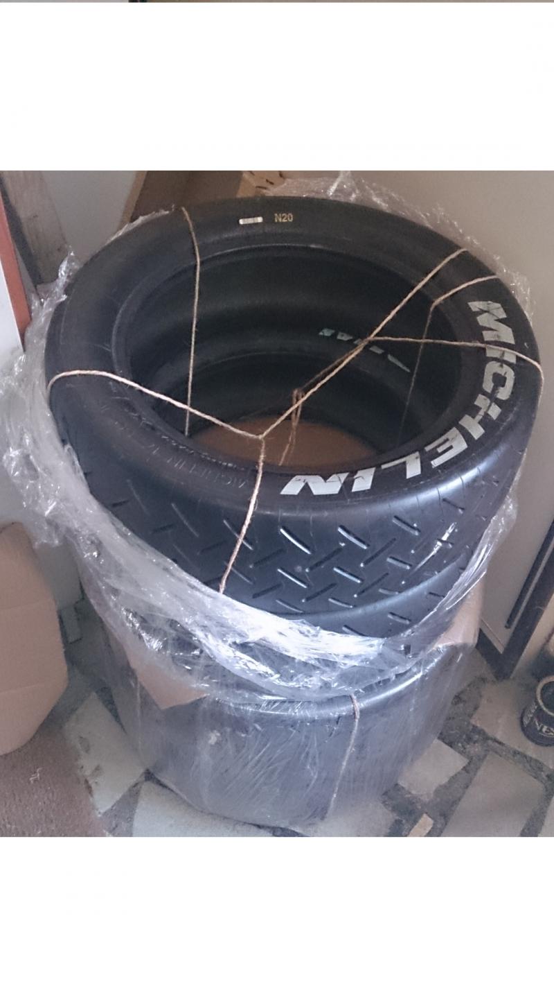

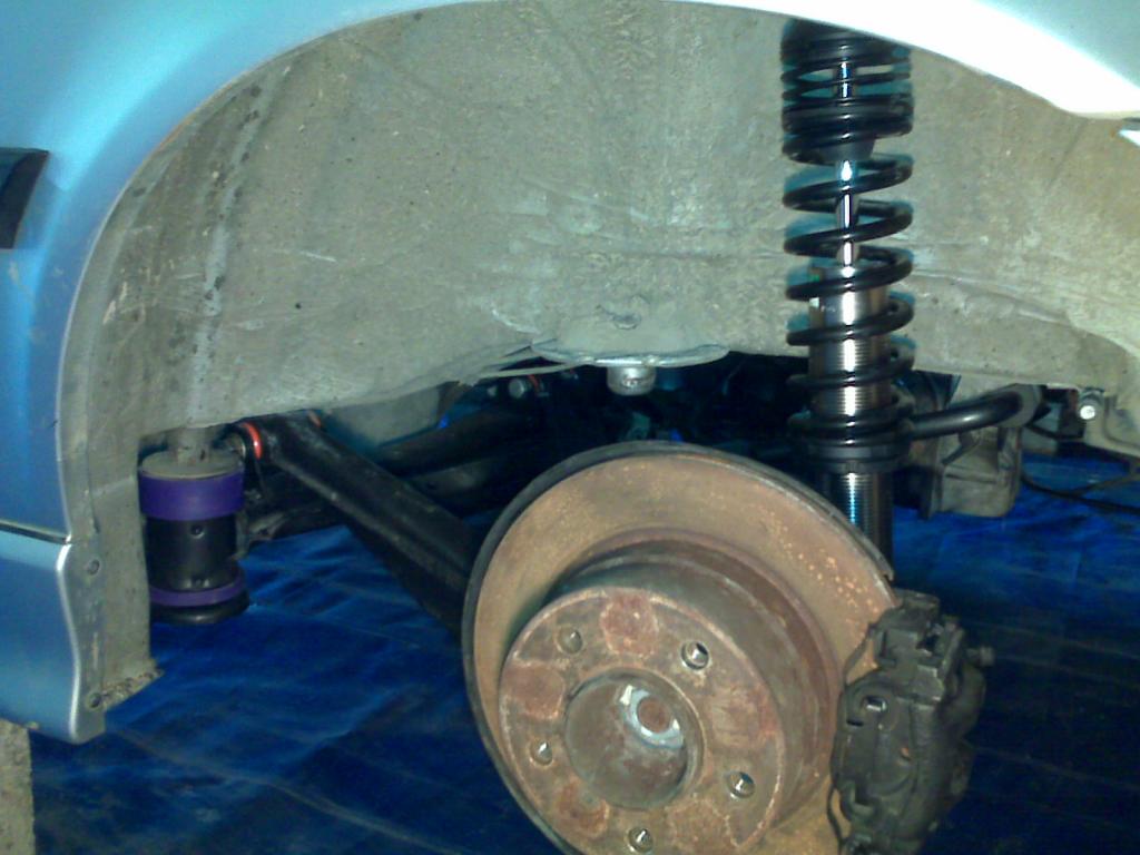

new tyres

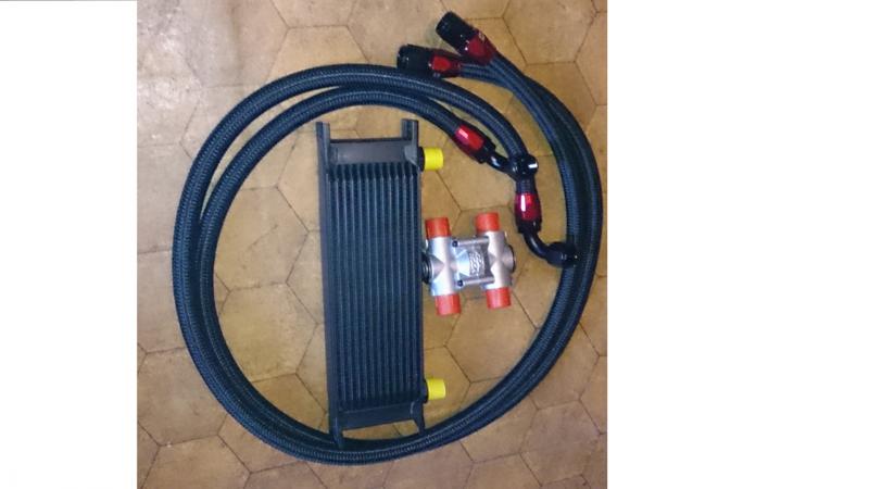

oil radiator + thermo and caps

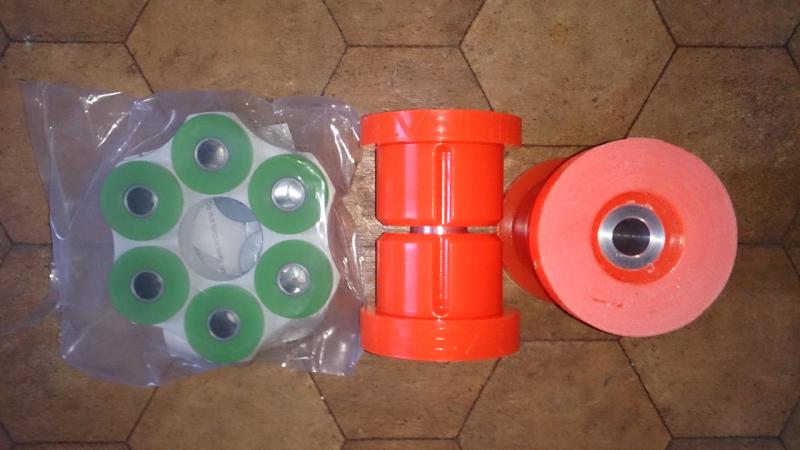

new rear subframe bushing 75A (the powerflex are too soft )
and better flector
