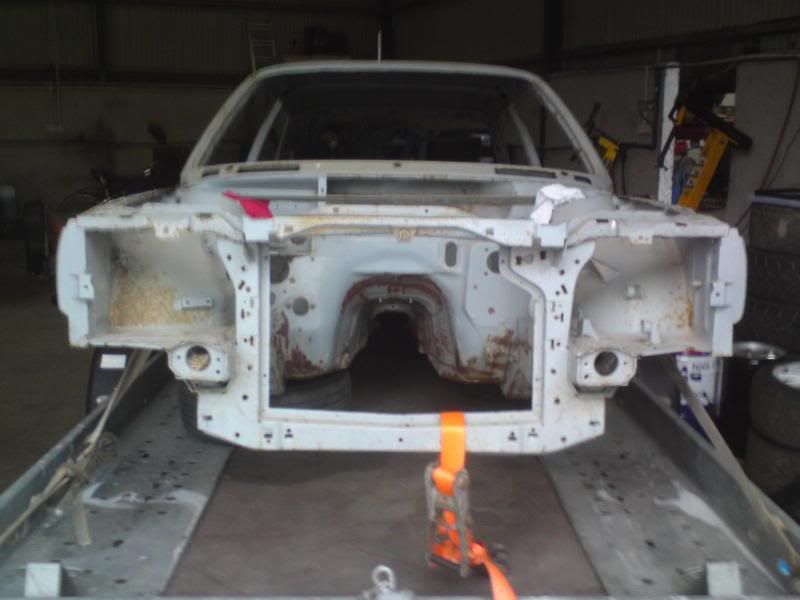

I had a new a new non M3 shell in storage for years,
Thought the time was right to build a replacement shell for my rally car, not that it's in need of replacing as it still in great nick,
I always wanted a proper GRP A Prodrive car, but seeing as there now making big money and getting very old I though why not build one,
New shell
I took all the under sealer and sound deader of it over 10 years a go and basically forgot about it, surprised how well it aged as some parts where left bare metal.
There is some surface rust, noting to worry about as a light blasting would remove it.
Brand new quarter panels, new inner arches, new rear panel and new evo 3 front wings are all on order from http://www.genuine-parts.de, a lot cheaper that the stealer.
As for the rear window frame I have to use one from a salvage car as there no longer available new,
If some has a new one for sale please PM me.
Once the quarter panels and rear panel are removed I will have shell soda blasted,

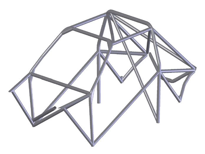

A full Matter spec roll cage has also been ordered from Custom Cages in T45 which is described as a factory spec cage,
As I understand it the shells used by Prodrive where in fact supplied by Matter.
