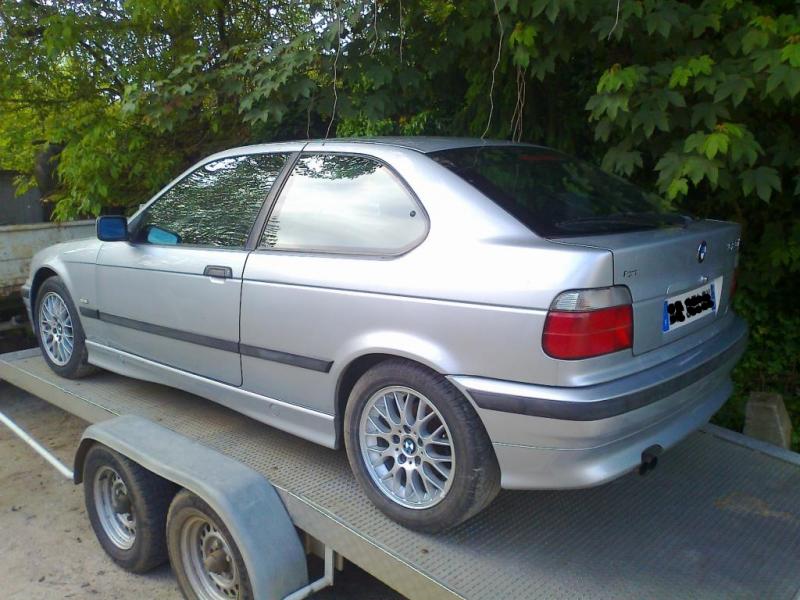

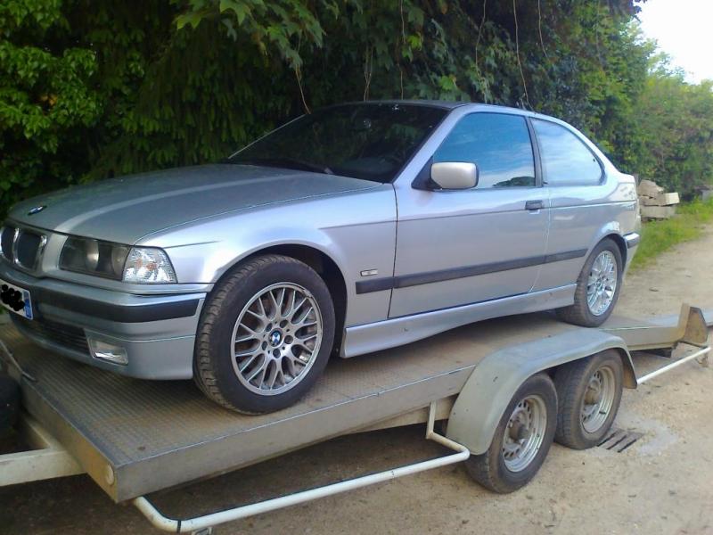

hi there after doing assistance since 3 years for my friends
i have decided its time for me to have my own car
founded a 323ti with a broken head gasket for 2000 € at 60 km from home
its a 02/98 model with 138000 km, i am the 4 owner
no rust,no apparent damages,but the rear was repainted

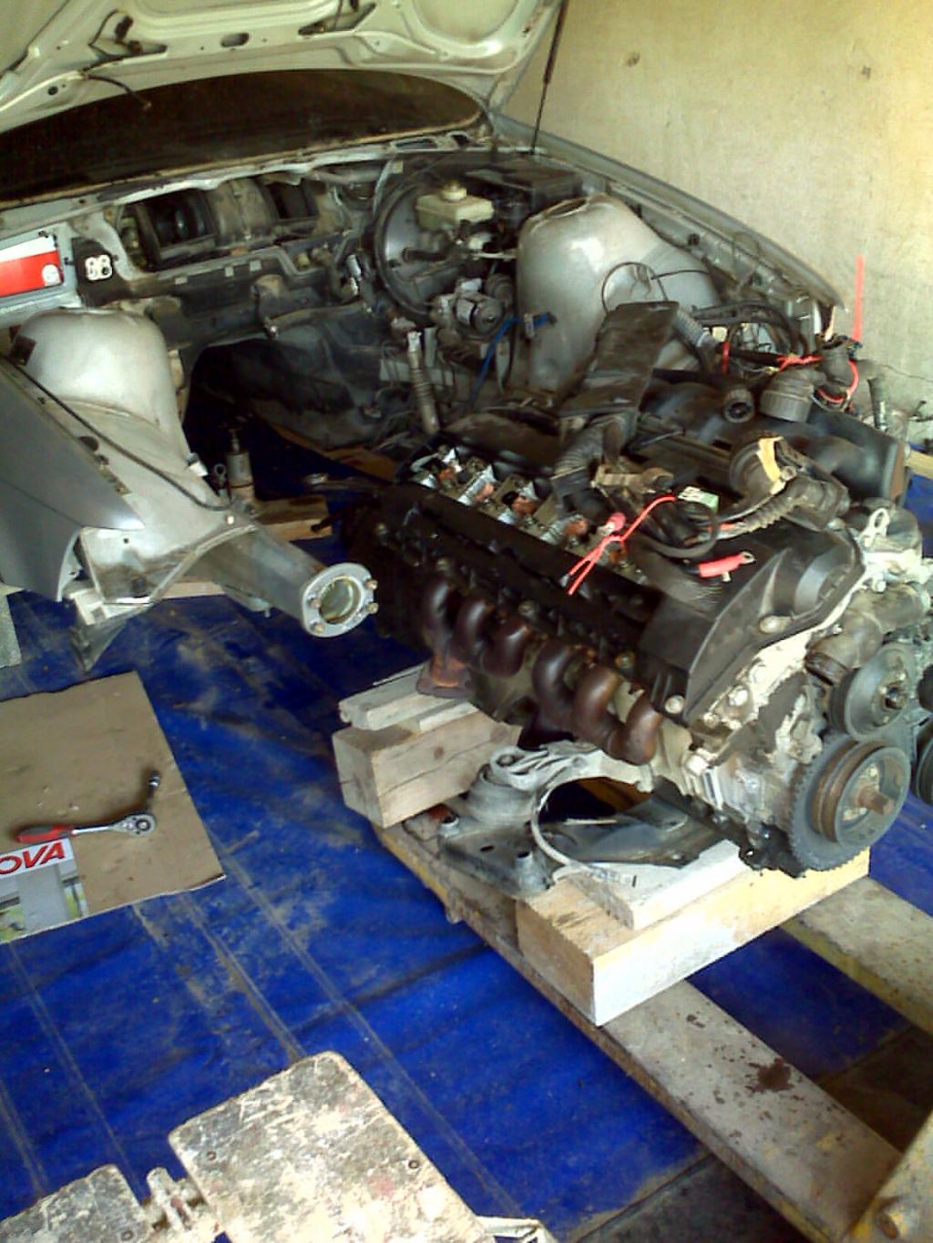

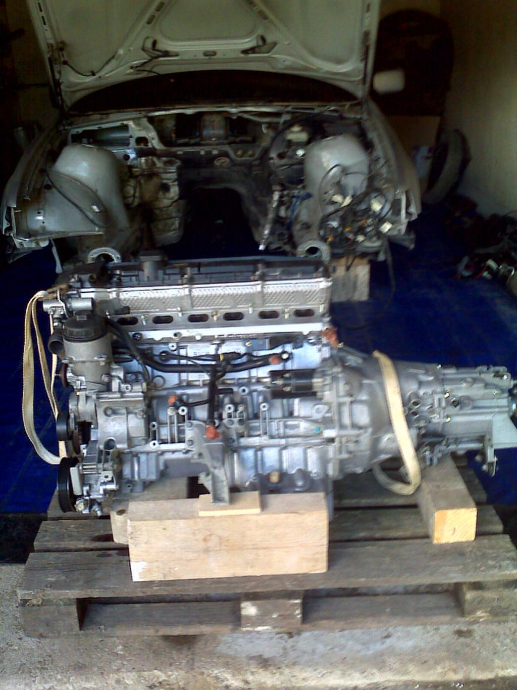

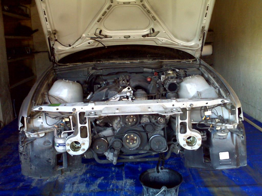

Postby samdemange » Tue Nov 24, 2015 1:24 am

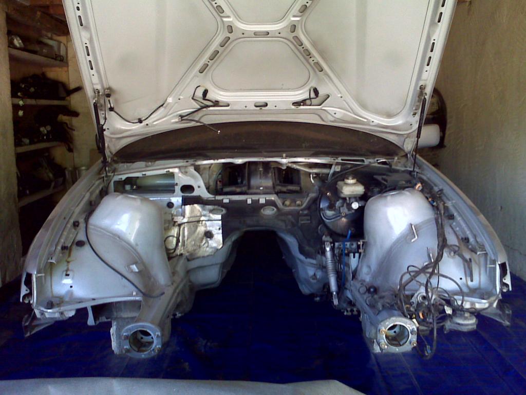

step one: dismantling
cleaning the engine before he goes to the mechanic
next soon....

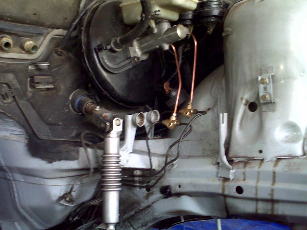

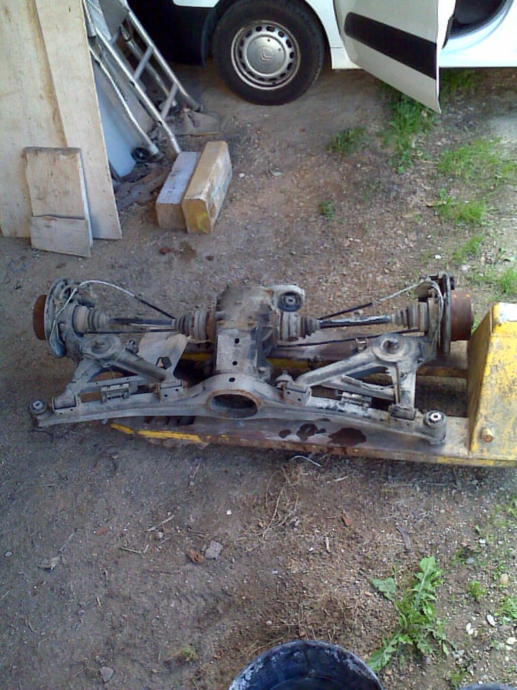

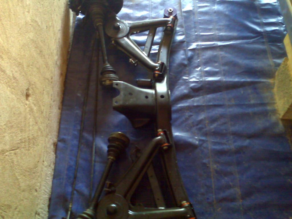

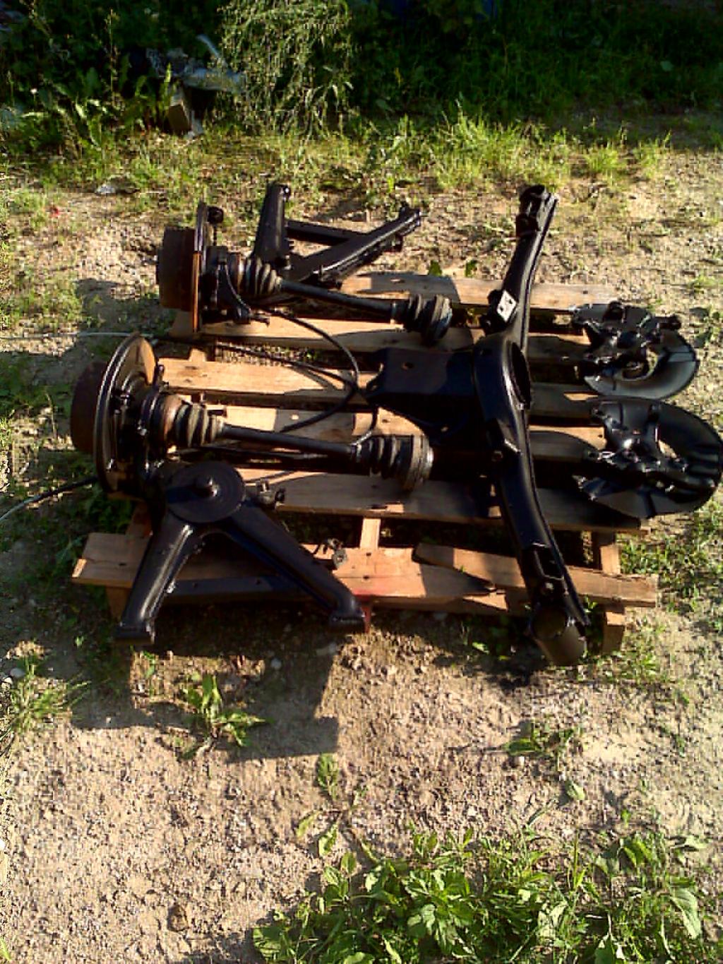

Postby samdemange » Wed Dec 16, 2015 5:24 pm
take off rear sub-frame
cleaning painting and new silent blocs (adjustable Kmac)
simplified brake line ( ABS fired )
make some space

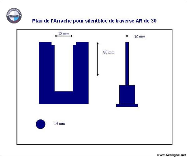

Re: 328 ti trackdays

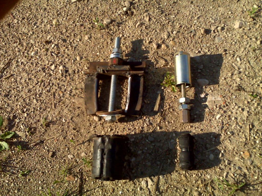

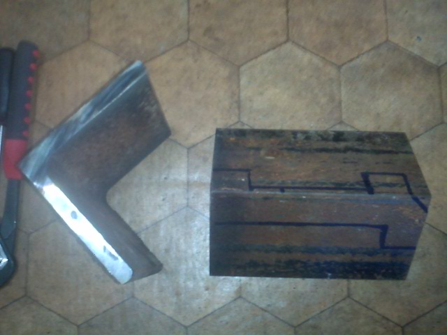

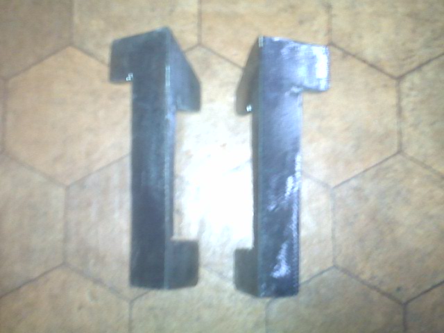

Postby samdemange » Sat Feb 06, 2016 3:13 pm
tool for the rear sub-frame bushing
cleaned engine bay

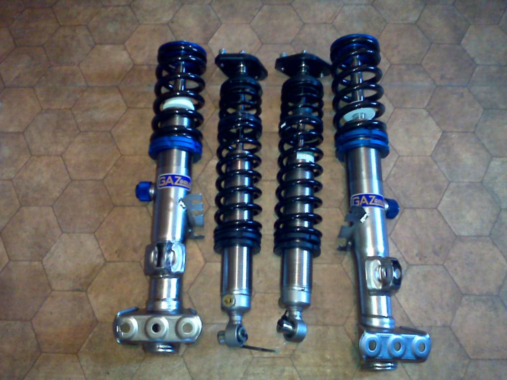

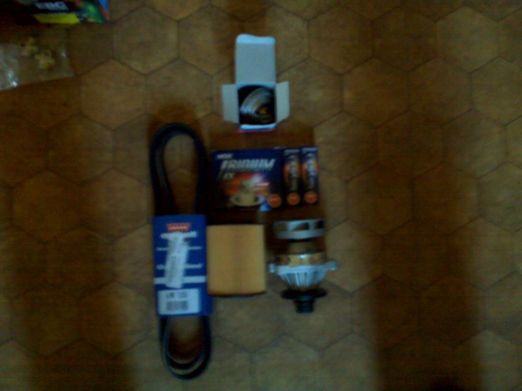

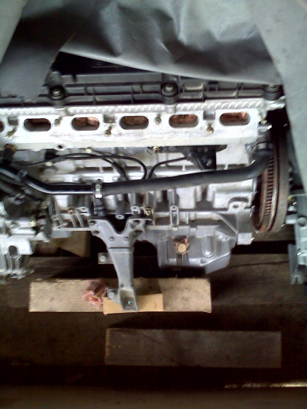

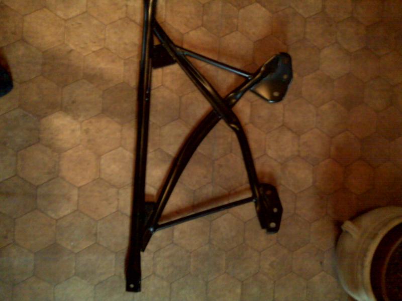

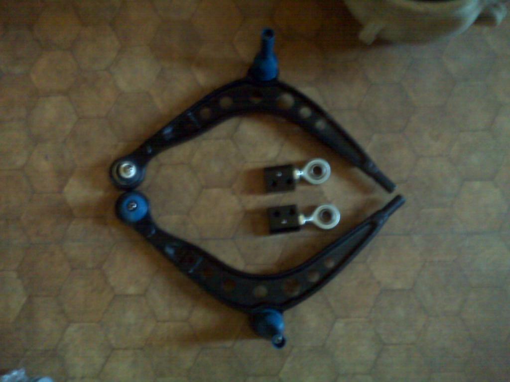

Postby samdemange » Sat Feb 06, 2016 3:19 pm

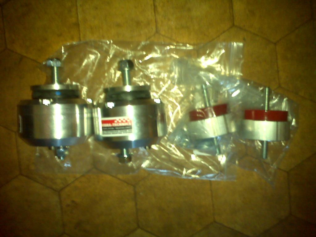

gaz gold coilover
front trailing part

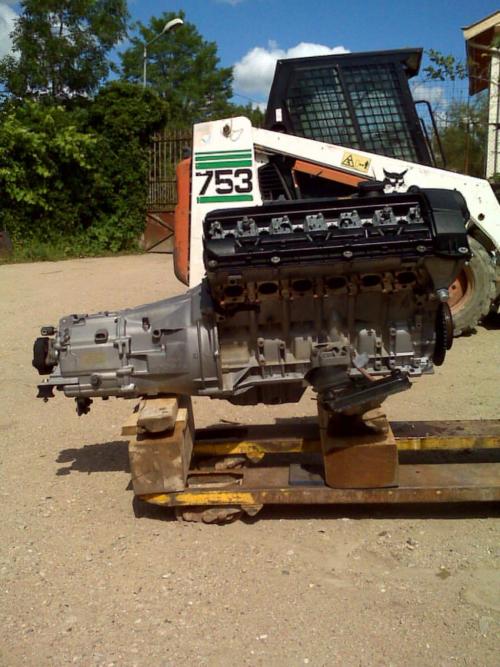

new water pump,belt,spark plug filter etc
motor,gearbox bushing

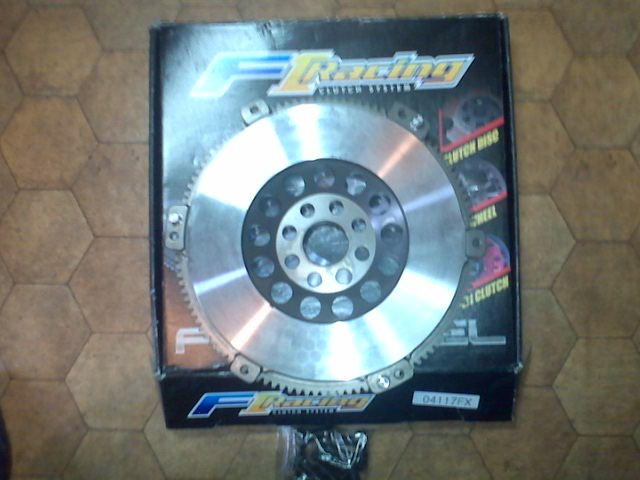

Postby samdemange » Sat Feb 06, 2016 3:26 pm

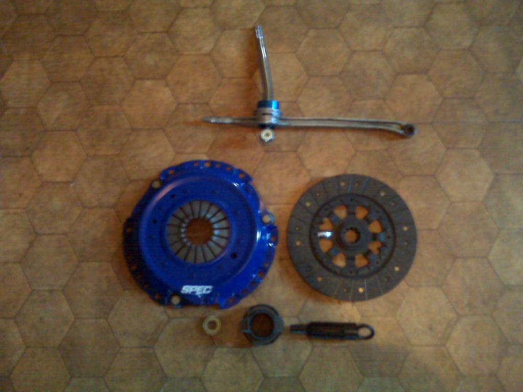

alu flange
clutch,shortshift
BMW parts

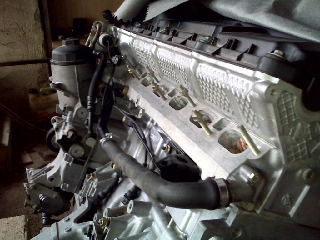

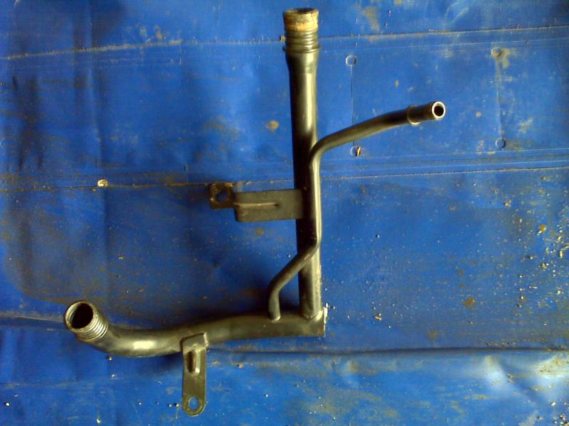

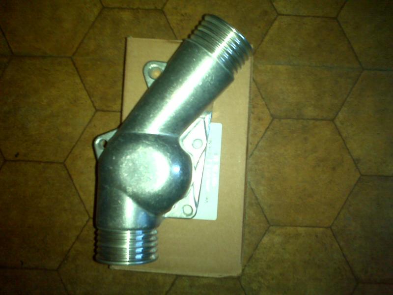

Postby samdemange » Sat Feb 06, 2016 3:31 pm
simplified coolant pipes
unwanted part

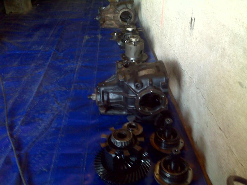

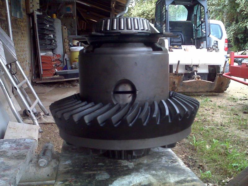

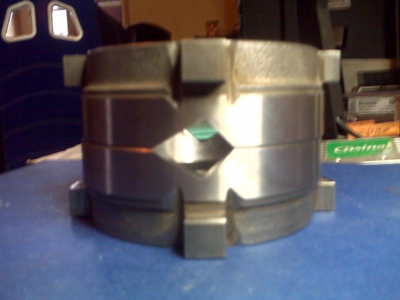

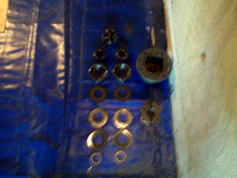

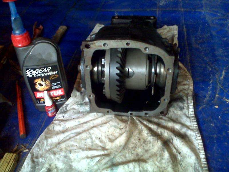

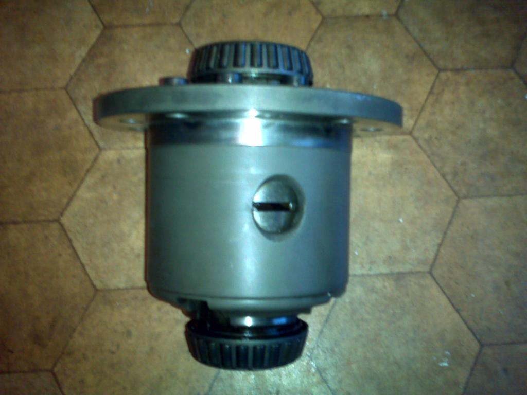

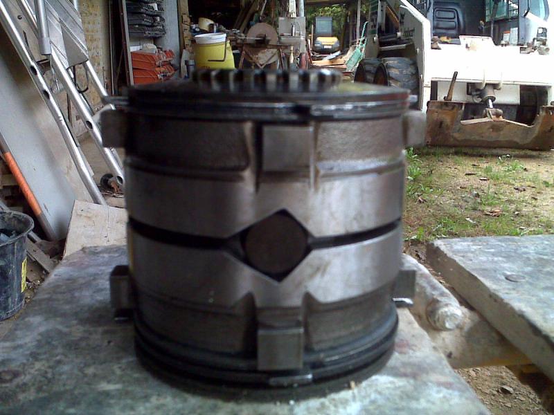

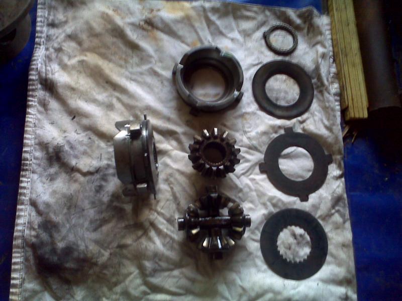

Postby samdemange » Sat Feb 06, 2016 3:42 pm

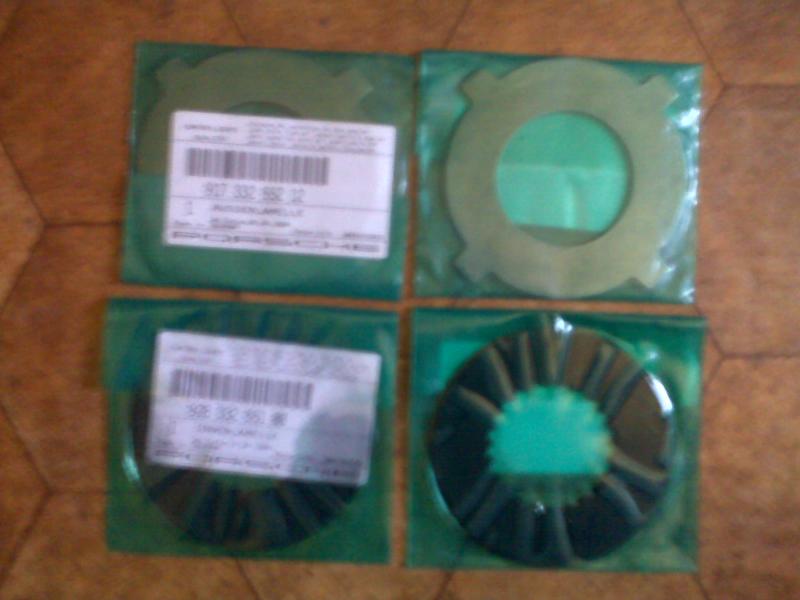

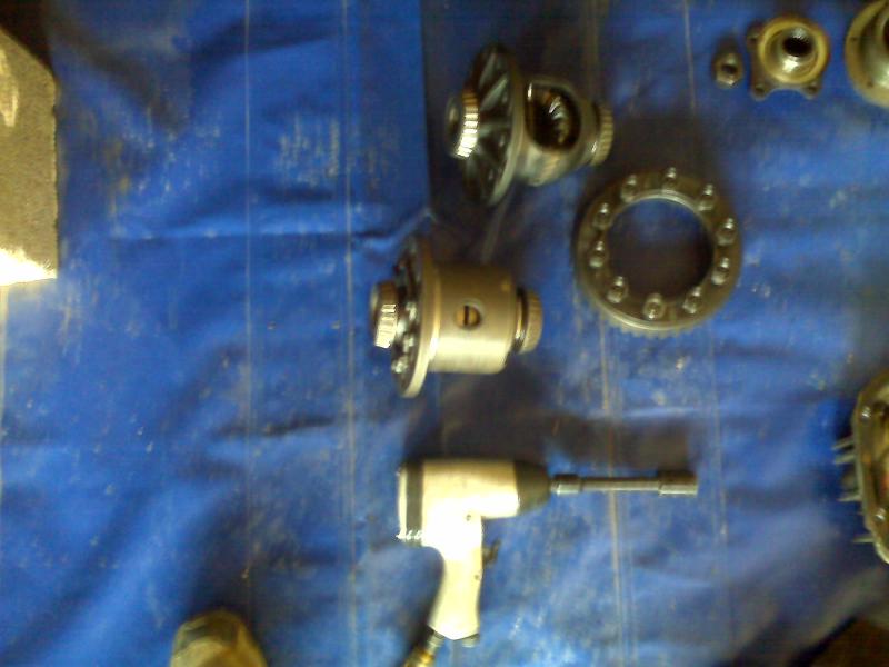

188 LSD
3.07 (323ti) VS 3.73 (E30)
new friction discs from Porsche dealer, the 968 LSD are the same
modified ramp for the LSD
re assembling

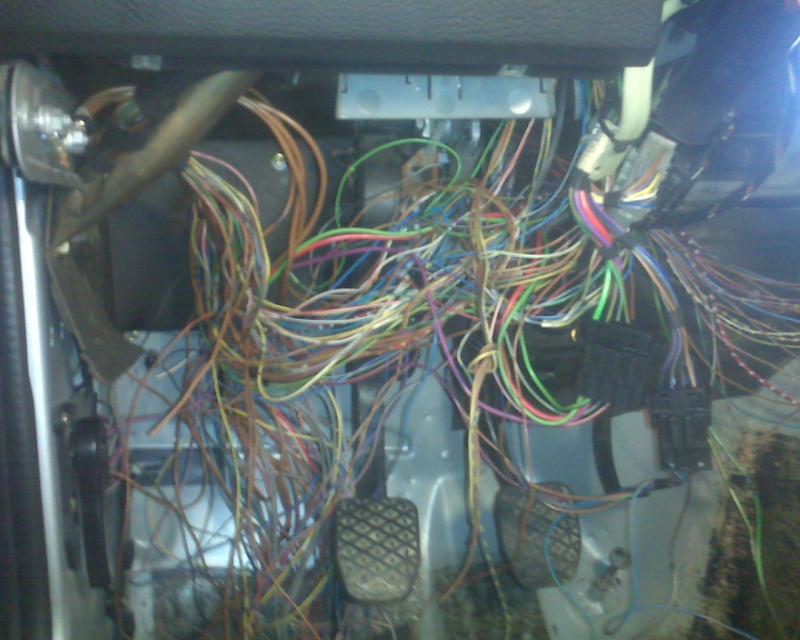

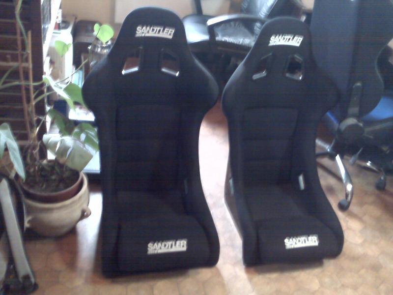

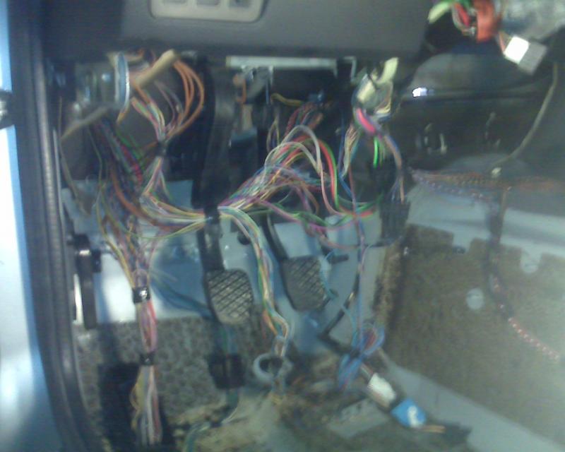

Postby samdemange » Sat Feb 06, 2016 3:50 pm

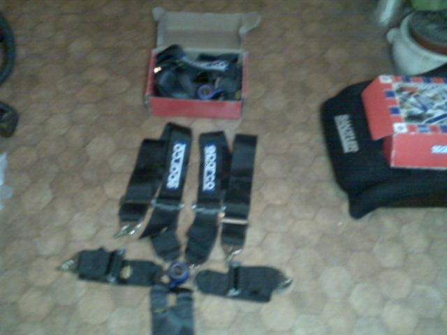

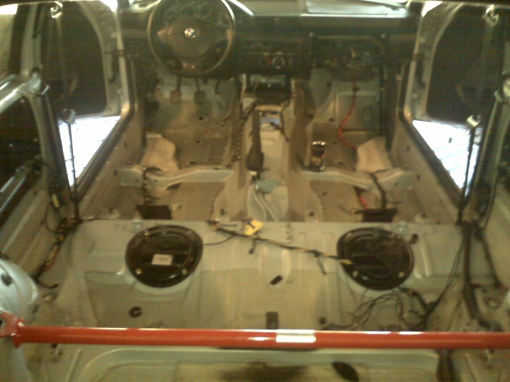

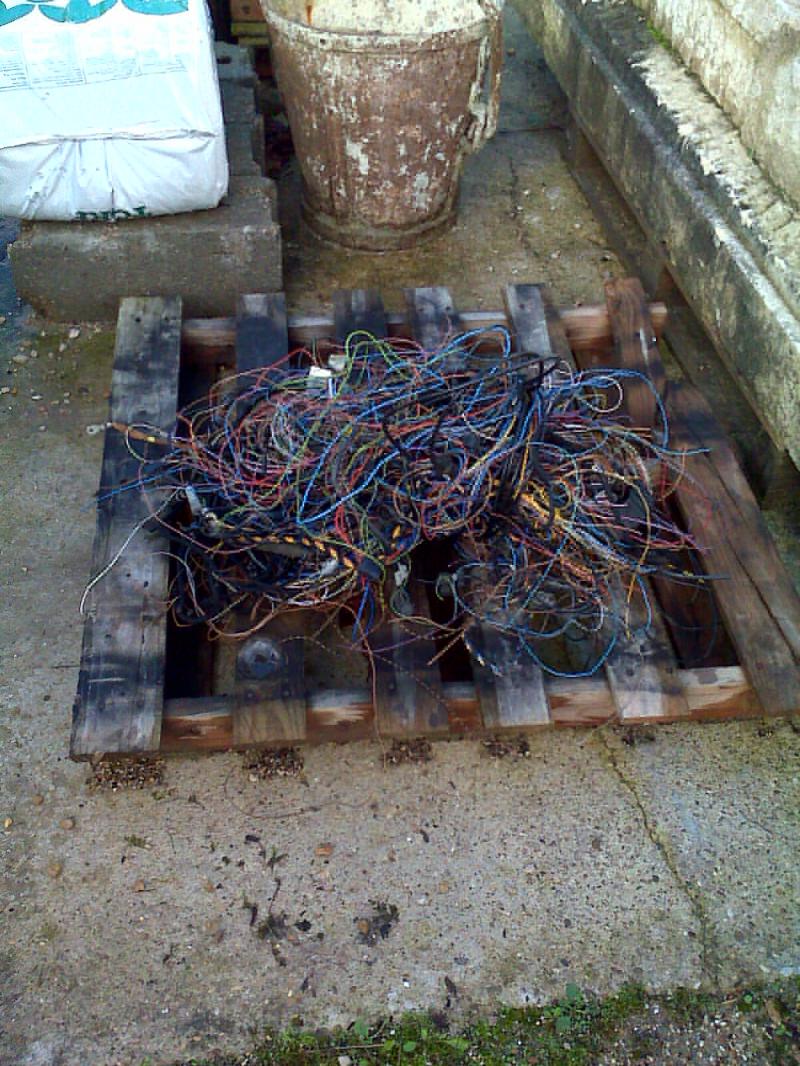

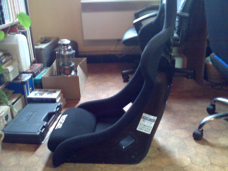

wiring exit
2nd hand bucket seat and harness
add HP make you faster in straight line

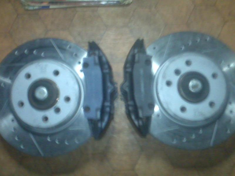

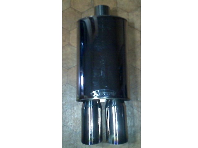

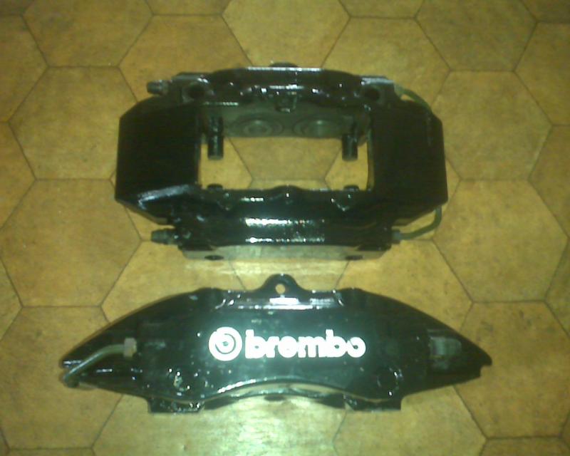

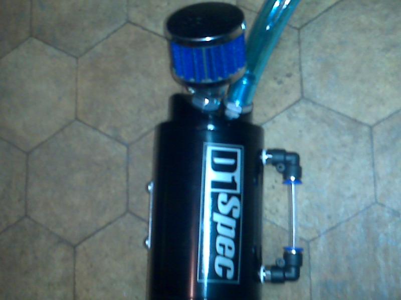

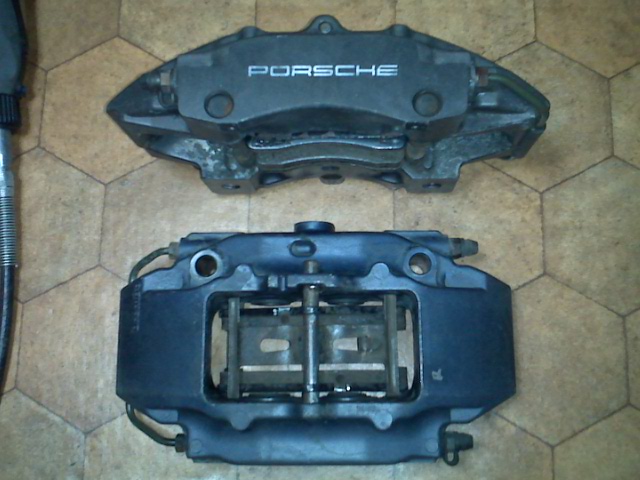

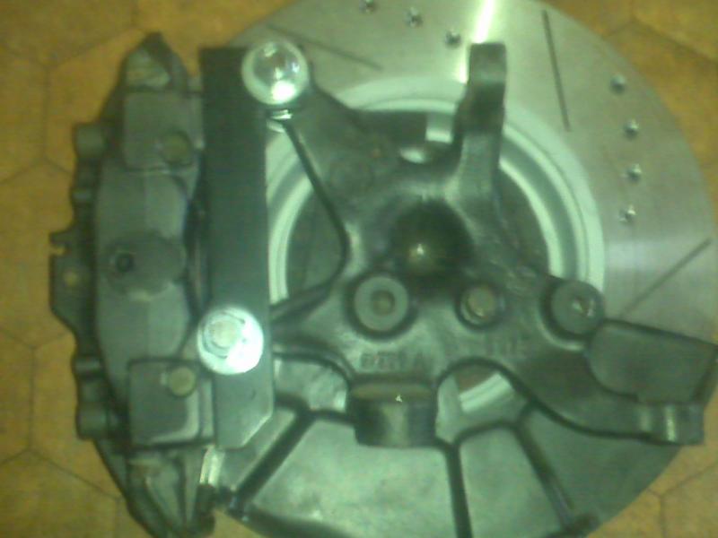

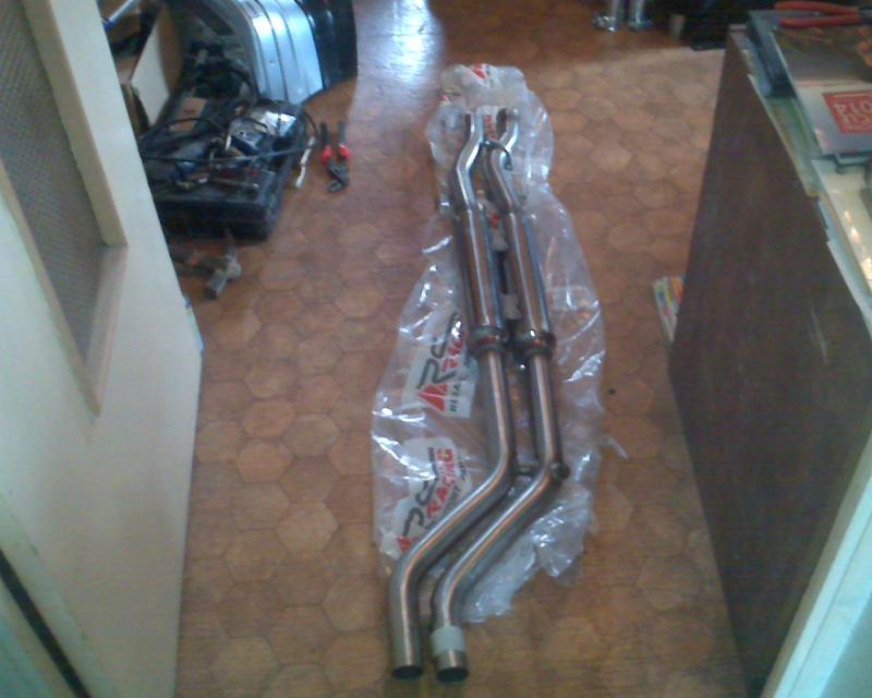

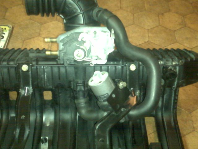

Postby samdemange » Mon Feb 08, 2016 11:37 pm

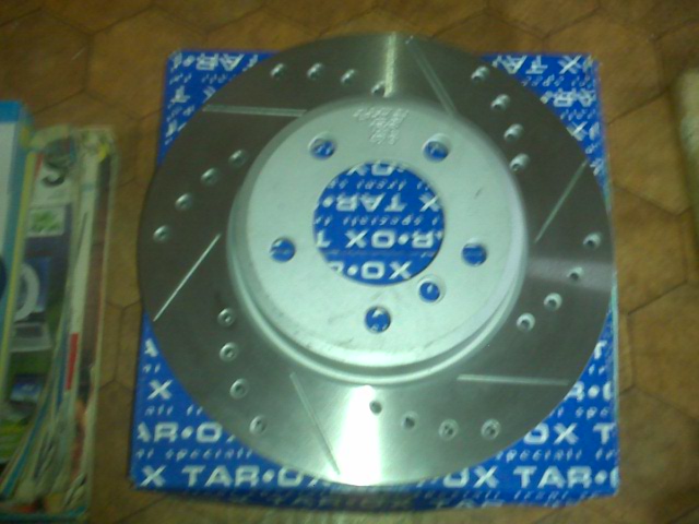

rear Porsche boxster caliper to fit the front discs
e46 300x22 grooved discs

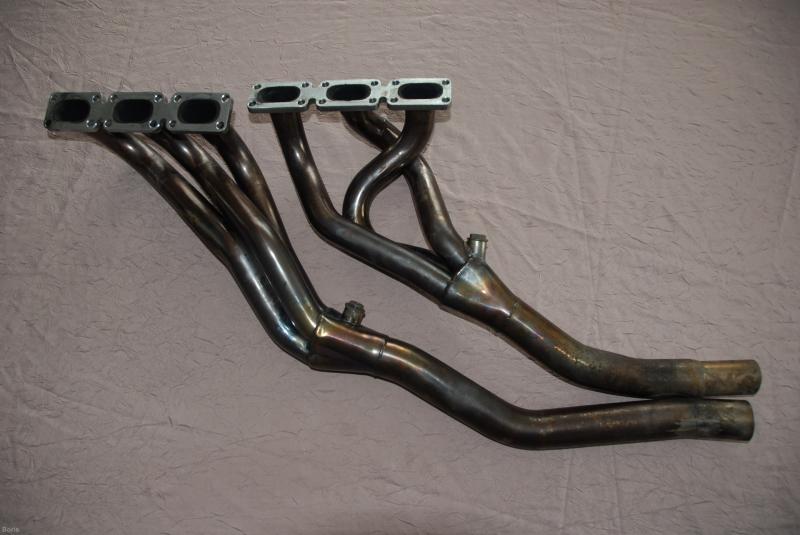

2nd hand supersrint header
325i line RC racing
universal muffler

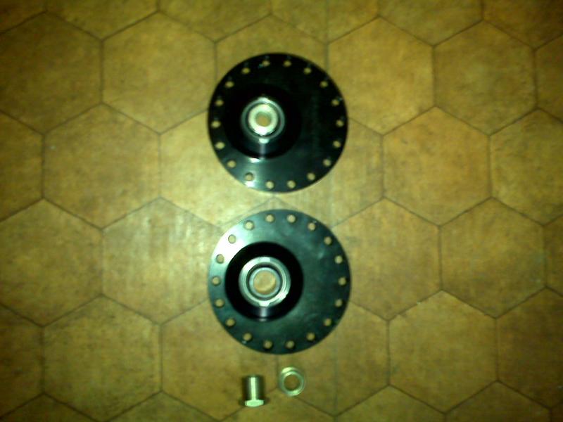

light flywheel (7.5 kg instead of 12.5 oem)

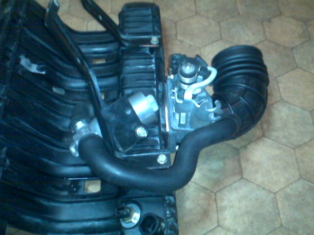

M50 intake manifold without oem pressure regulating valve ( catch tank instead )

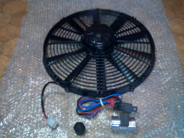

SPAL instead of the thermo fan
lose weight make you faster every where
(colin chapman )

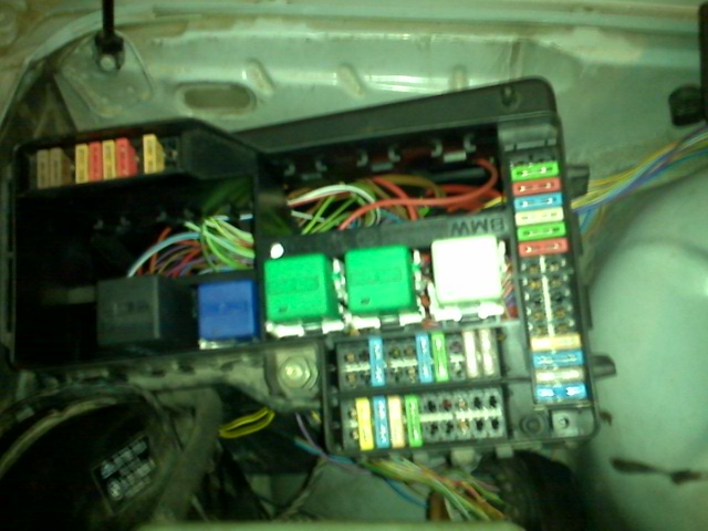

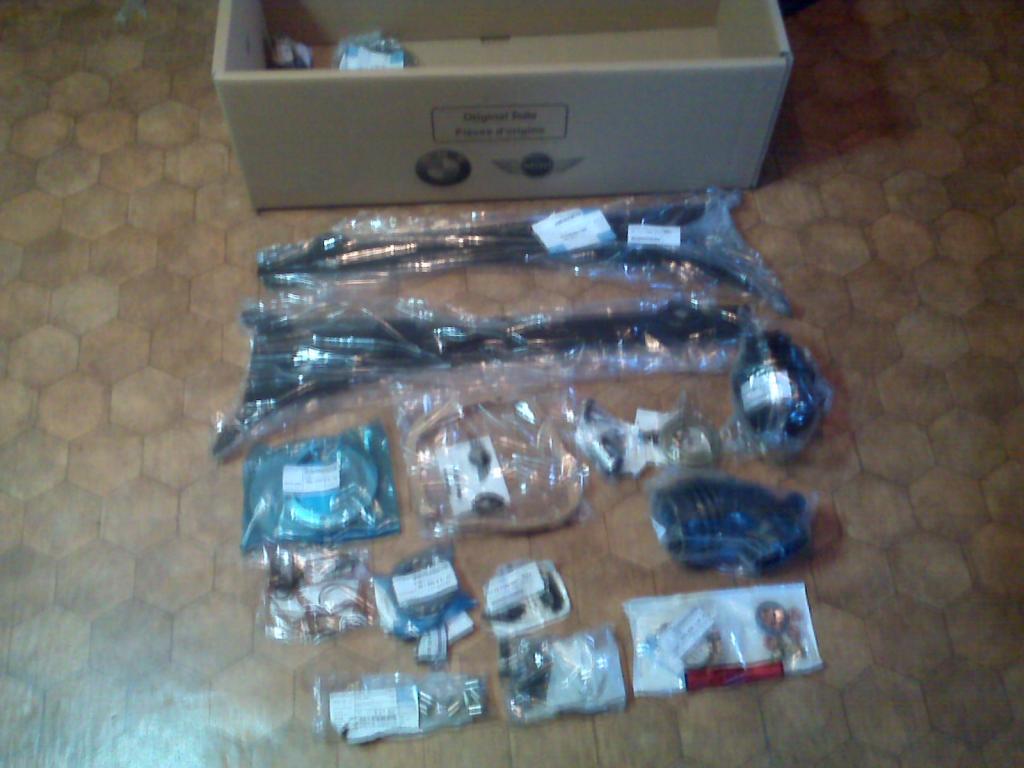

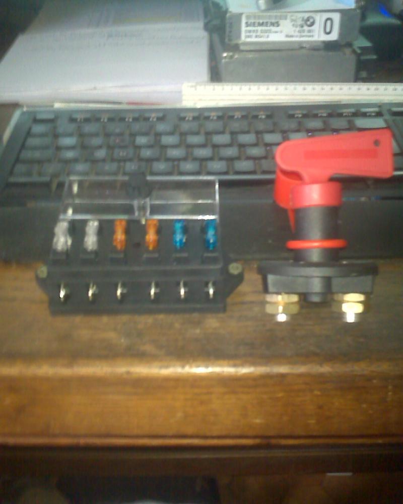

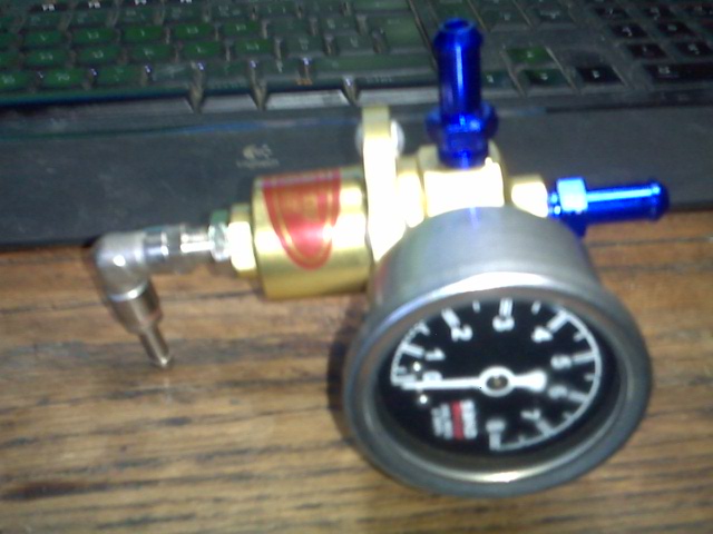

Postby samdemange » Mon Feb 08, 2016 11:42 pm

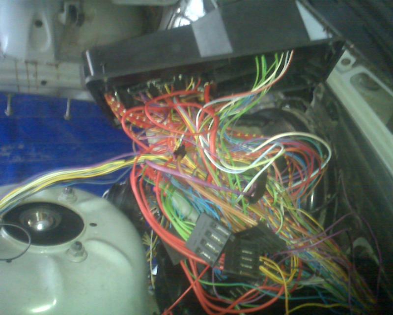

fuel regulator
oversimplifying of the fuse box
big headache with all that wires :oops:
happy to have the ETM manual to help
link can be helpful
http://wedophones.com/Manuals/BMW/

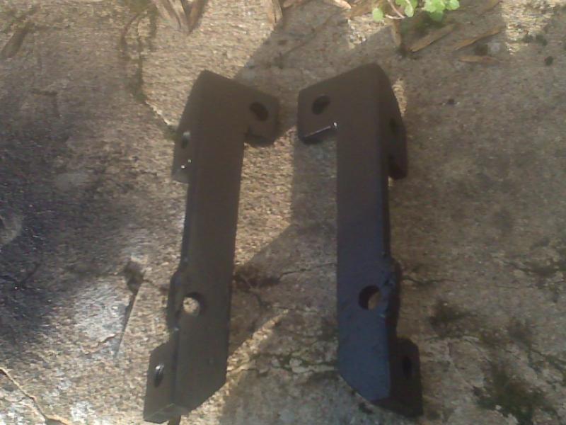

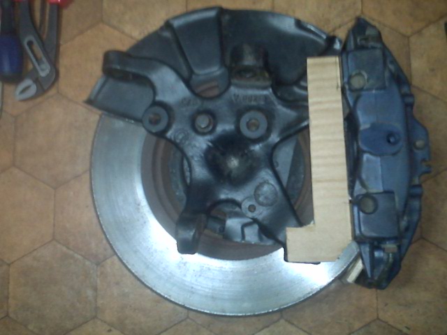

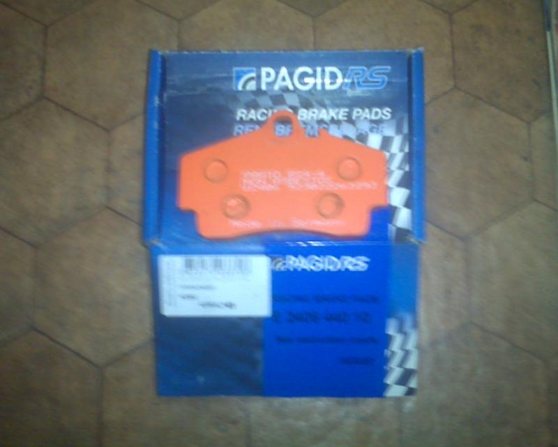

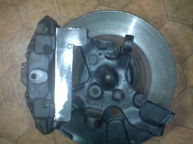

Postby samdemange » Mon Feb 08, 2016 11:49 pm
home made bracket for the front calipers
new pads Pagid RS4.4
