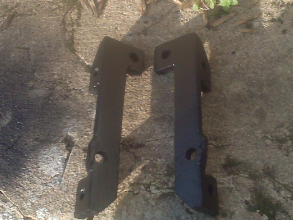

Postby samdemange » Tue Feb 09, 2016 7:45 pm
made this for mine
with 300x22 discs ( e46 ) and rear 386 boxster calipers
and a home made adapter for them
16' rims just fit

Re: Porsche brake conversion e36
Postby pets56 » Wed Oct 26, 2016 6:10 pm
But how you solved rear brakes. Also porche calibers?
