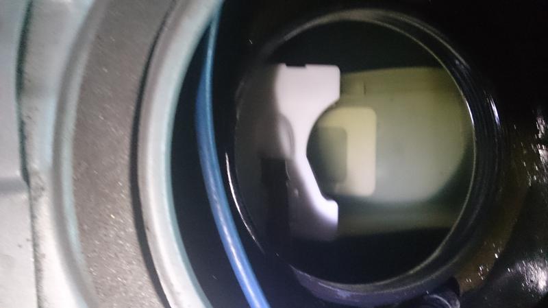

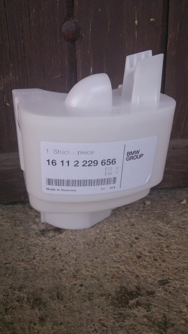

M3 e 46 baffle because when the gas was under the half of the tank i have a starvation trouble with right corner
15€58 at my bmw dealer

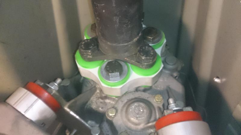

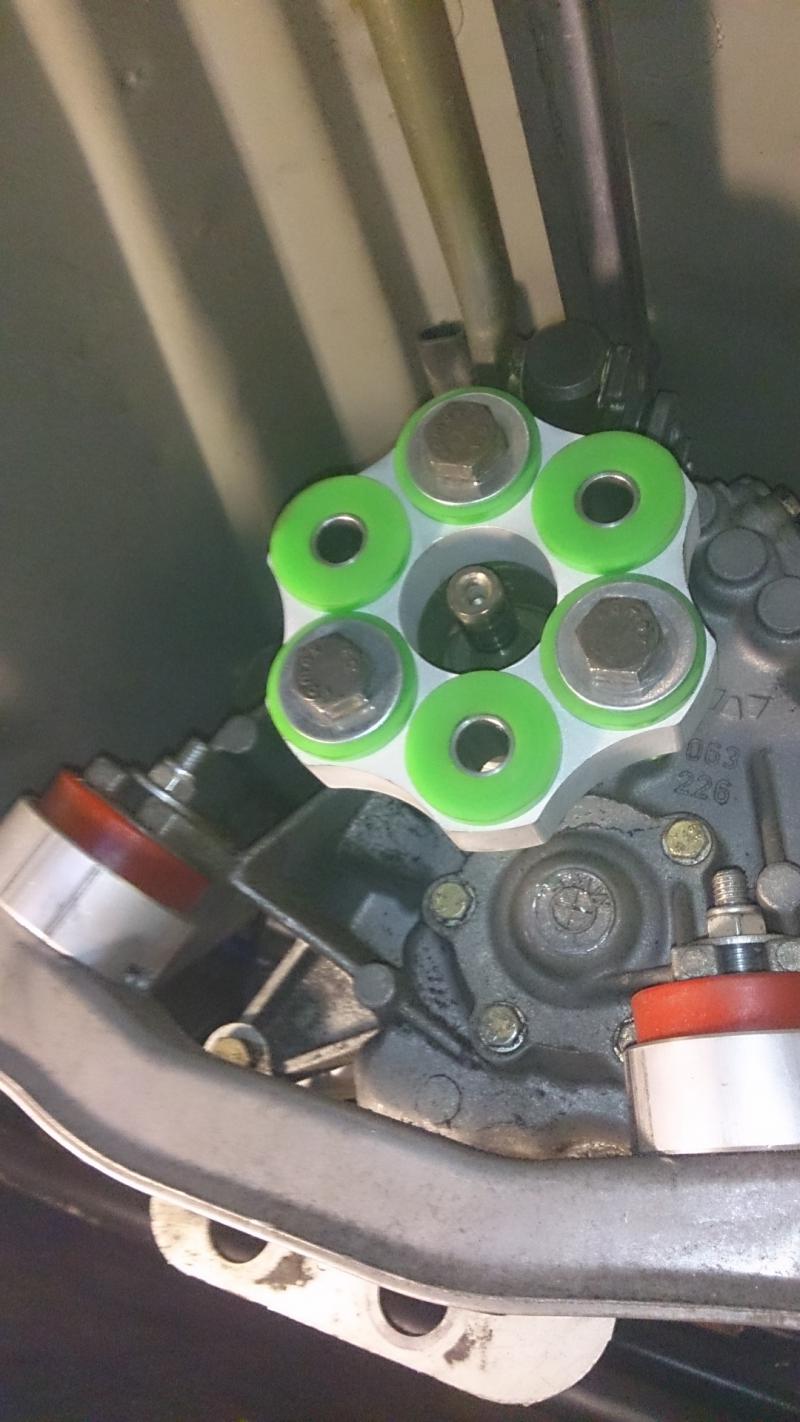

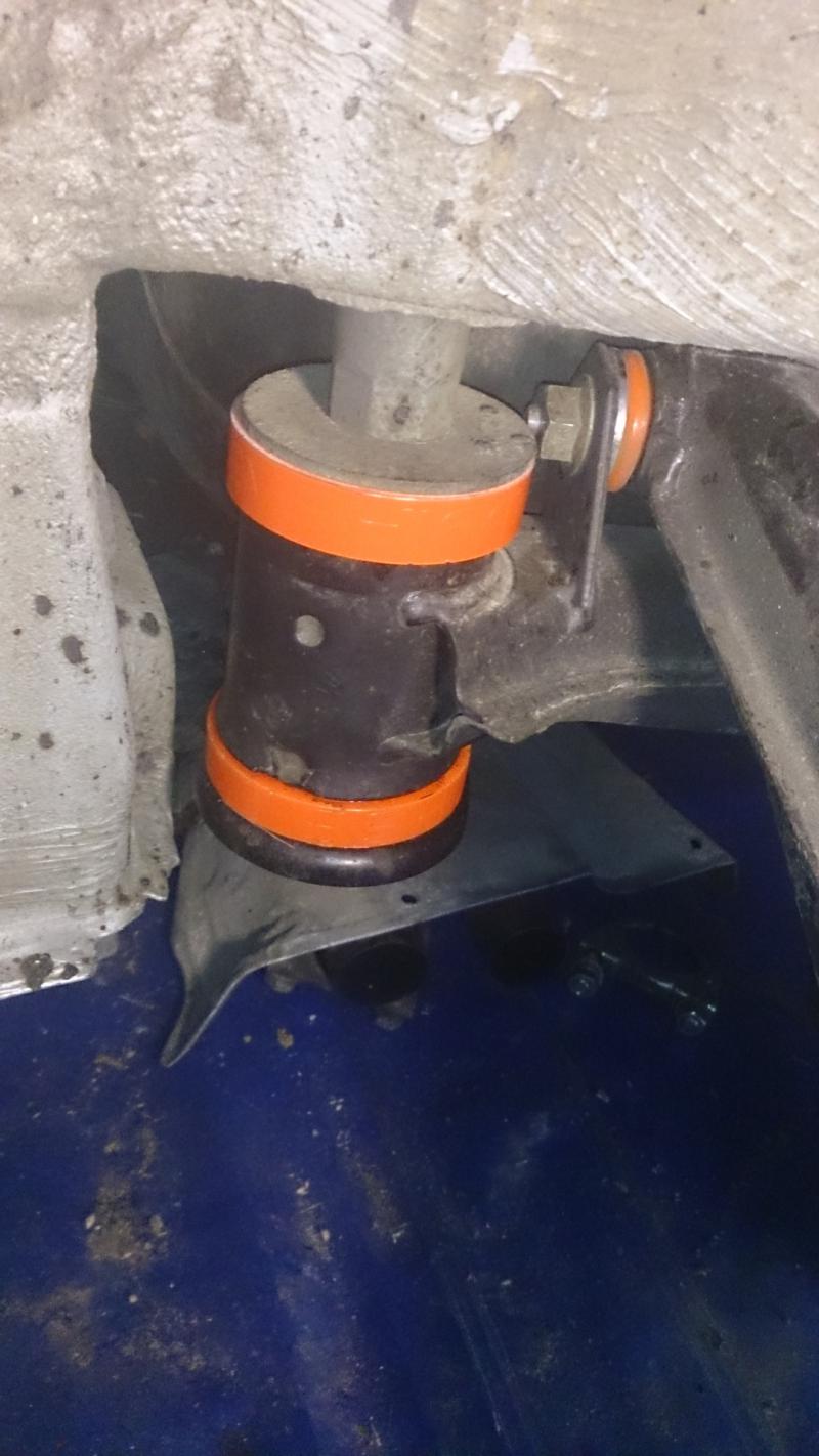

revshift 75A polybush for the rear subframe because the purple powerflex are too soft
at the same time revshift trans guilbo
