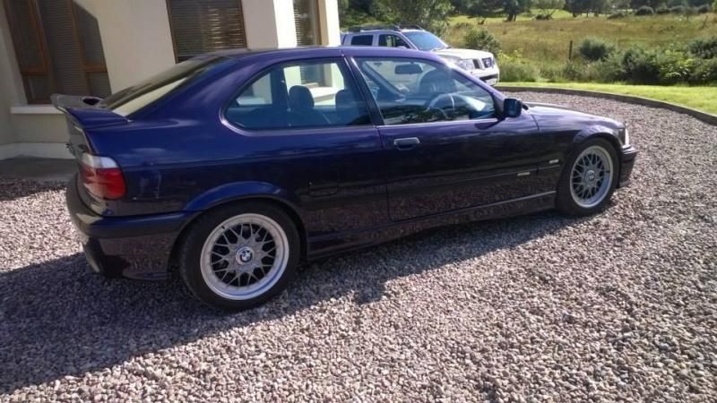

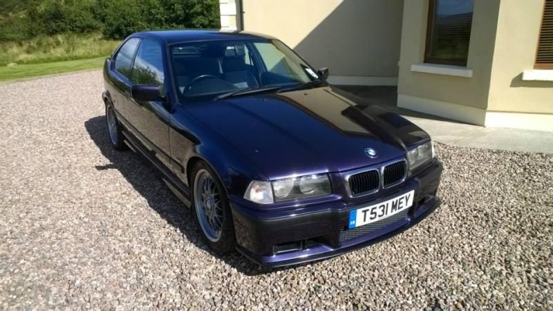

I recently bought this road car to see how well it would go with potential to be a competition car.
The guy who built it done a great job & everything looks factory standard.
Lots of thoughts & lots of questions on which way to go with it but thought I'd fire up some pics first.
Cheers,
David

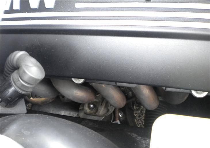

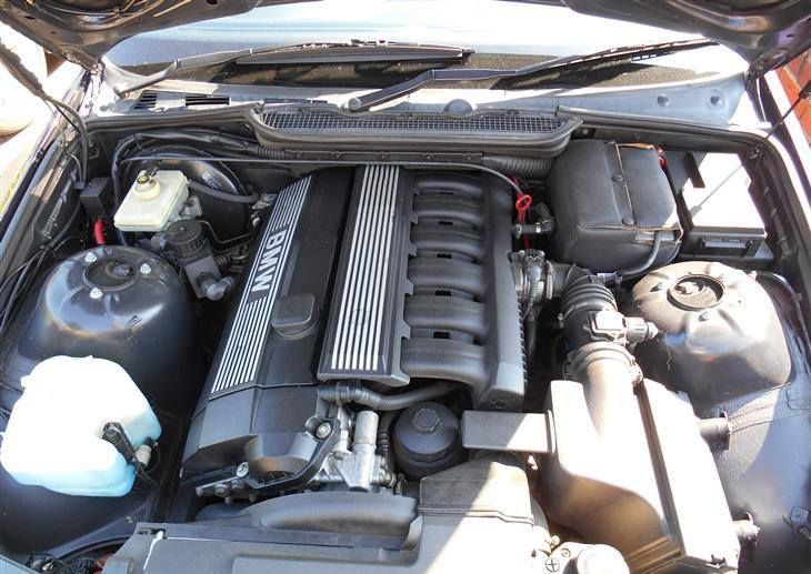

Ye can see the M50 inlet, M3 exhaust etc. If its had remap it should be 220-230 depending if its also had cams could be more?
Suspension wise, the front we have legs made to take Escort long inserts and coilover springs.
Rears are the problem as i dont like coilovers on the back, other people use them tho without issues.

mrfuzzyfelts wrote:Ye can see the M50 inlet, M3 exhaust etc. If its had remap it should be 220-230 depending if its also had cams could be more?
Its got USA M3 spec cams & an END Tuning remap according to previous owner & have receipts for them too from the US. Its got a Hayward & Scott stainless steel back section of exhaust that the previous owner paid £700 !! :shock:
