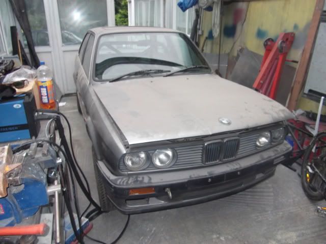

New thread for a new car, collected the new shell today with the cage and other bits, will get busy ordering suspension components tomorrow, give it a quick was and start stripping her down. its a povo spec 1989 316 in lachssilber with a mere 70k on the clock, been dry stored for a number of years so it also comes with extra thick dust paint protection and best of all the rare rot free option, bar the scuttle just starting to go on both sides and a tiny patch on the inner sill, there isnt a crusty bit on it. It wont be quite as fancy as the last shell but the moving bits should be just as good. Watch this space for updates!

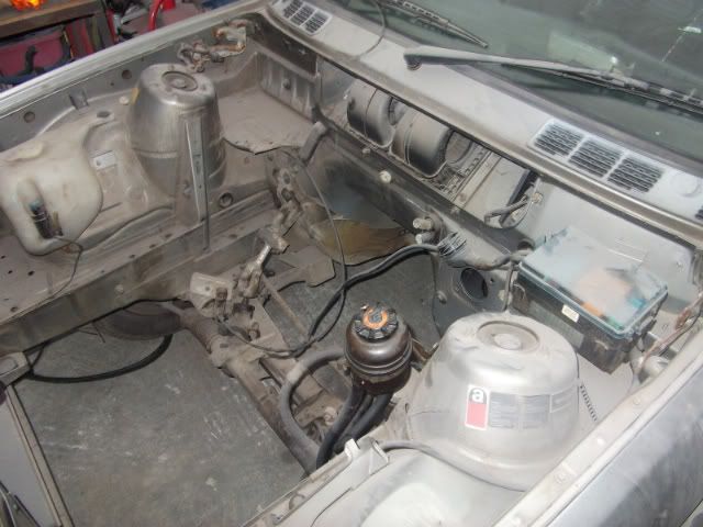

Got the Car stripped down, wiring has been thinned out to its bare essentials, now awaiting some spiral conduit to finish it off but that can wait until some of the auxilary circuits have been wired in closer to the end. After alot of cursing the sunroof came out. All the other ones which iive done in the past have been so rotten that the fell out, this one on the other hand was factory fresh and needed much careful persuasion with the heat gun before it let go.
Tigged in a filler plate today, another annoyingly fiddly job but its done now. My mate helped me out and scrapped out all the tar sound deadening off the floors so now its up to me with the thinners :evil: The engine bay has also been relieved of all its unwanted brackets and threaded nipples, so next step will be the fabrication by the looks of it!

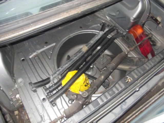

Got the rollcage feet welded in, cut off the saddle brackets for the single door bars and ordered tube and brackets for removeable X door bars, thats on tomorrows to do list!
