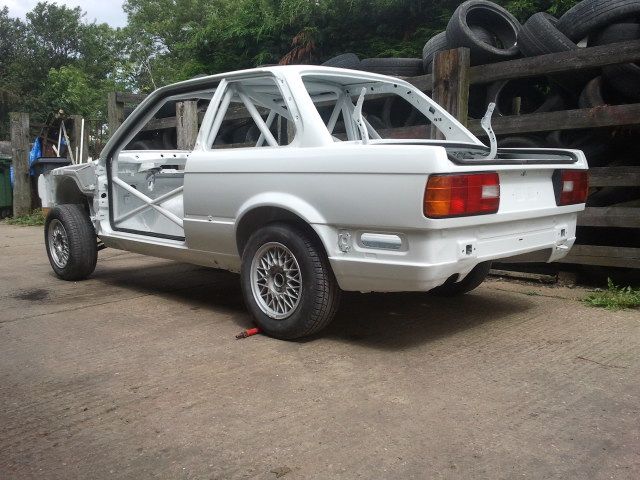

Postby Adam Gardner » Mon Jul 30, 2012 11:25 pm
Big day today! Shells in paint and i have bolted a couple of bits back on it. back lights and boot and door seals counts doesn't it!!!
