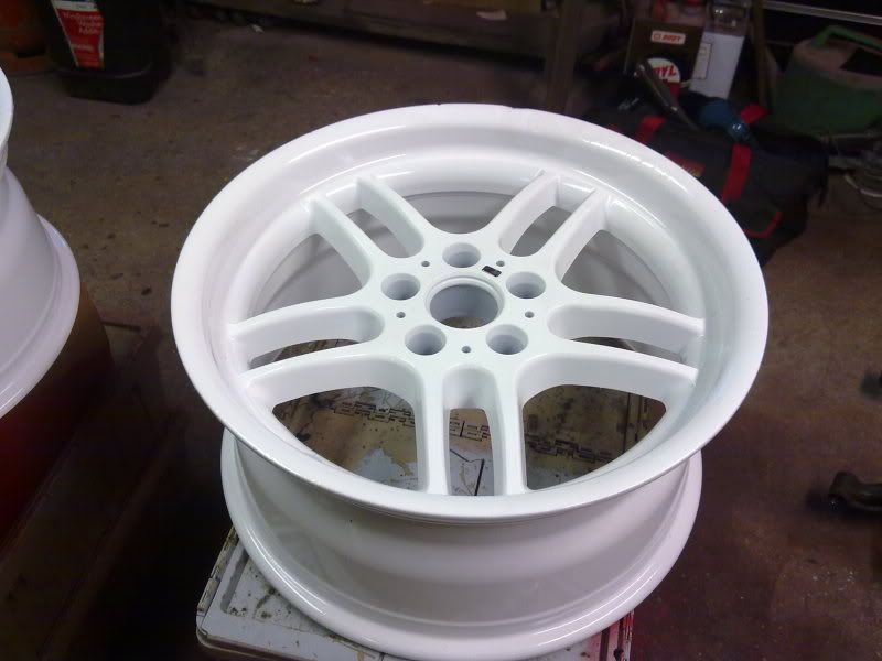

The car was purchased from Ireland for £3K Cash, and it cost approx £250 with ferry costs and petrol to get her home, But ive all ready sold the Leather Seats pictured below for £200, and the wheels also pictured below for £250 as they were 17" BMW items and i intend on running wide 18"'s
So the car as she stands now owes me £2800 so for the spec and bits left on her i think thats a bit of a bargain !!!!!

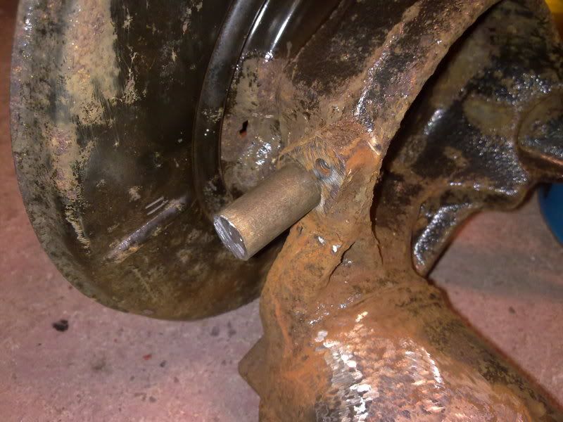

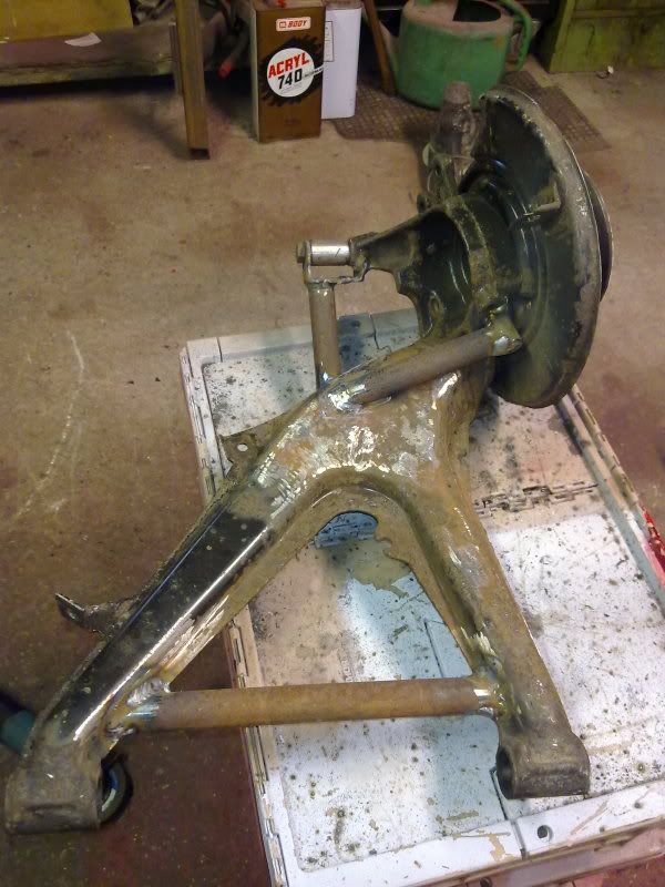

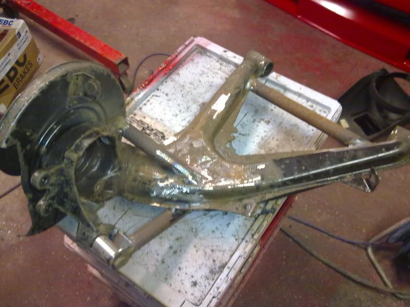

I've been looking at other peoples build's on here and other pic's on such website's as Delage etc and after my prvious experiances with GrpA Cossie Rear Wishbones here a couple of pic's of my attempt to strengthen the Rear Compact wishbones with a compromise between adding weight and adding strength etc !!!!!
what ive done above is pressed a 18mm dowel into the ABS hole in the hub which is half way up the hub, i then welded it into place and then braced it down to the wishbone pictured below :-
Also pictured in the pic is the strengthened shocker mount and the removed original BMW spring mounting plate.

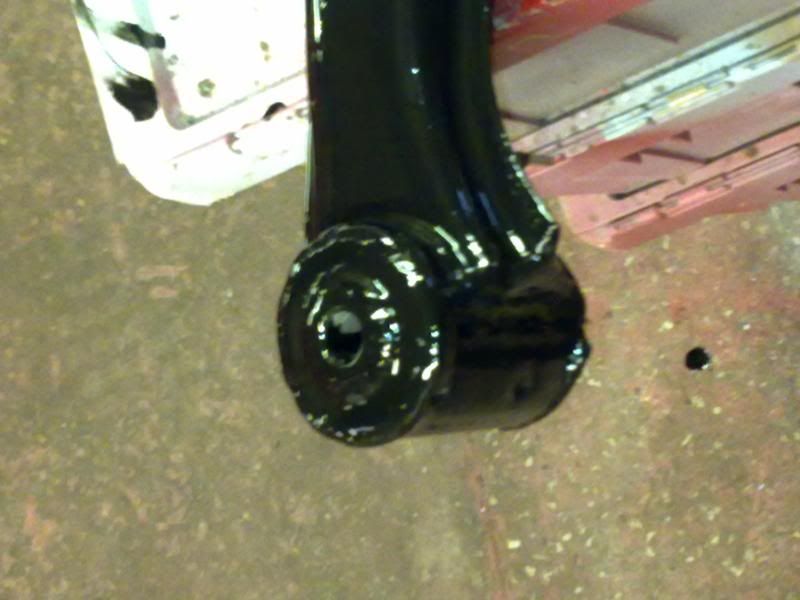

And lastly the cross brace betwen both mounting bushes of the wishbone.

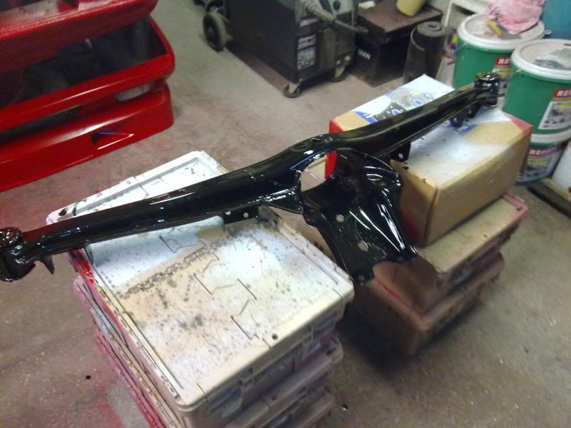

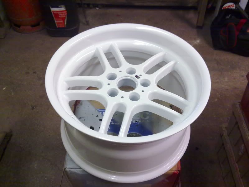

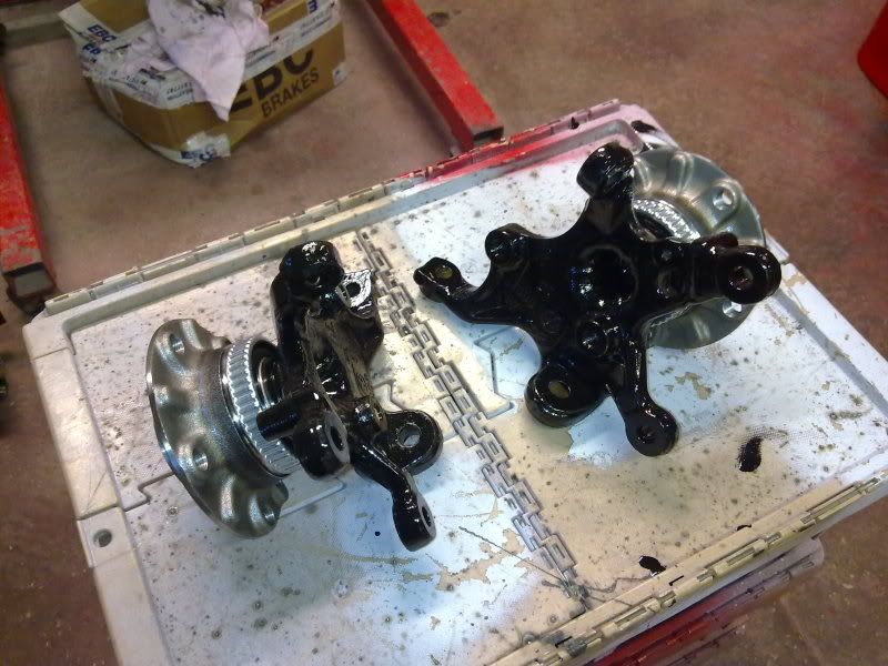

Postby Daishag » Mon Feb 07, 2011 6:51 pm
Right then some more photos but not sure of the quality as they were taken on my phone but here goes
M3 Stub axles ready to go with new hubs,
Couple of pics of the 18" alloys i had off Andy (evofixer) they should fill the arches well as they are staggered items etc

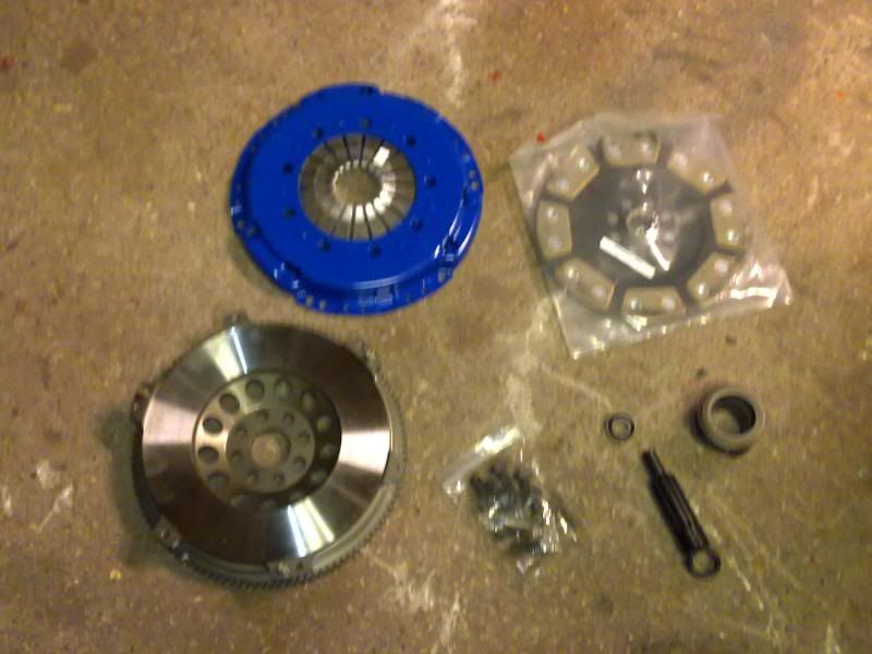

Picture of the Steel Solid Flywheel, Paddle Clutch & Sachs Pressure Plate waiting to go in
And lastly the rear beam all strentghened and painted with the solid mounting bushes welded into place

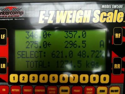

Just found this !!!!! The previous owner who built the car for drifting sent it me and i forgot all about it, it shows the corner wieghts and total wieght, remember this was done with running gear she is fitted with at the mo ie M3 engine etc and all the leather interior fitted as a road going car etc.
I think its really promising once all the crap has gone and the weight distribution is good all ready

Does any one know what the figures in the centre of the screen mean ???? ie
SELECT : 621.0 48.72%
I know the figures above are the actual corner wieghts and when added together they give the Total Wieght show at the bottom of the screen, but i really don't know what the figures mentioned are may be a front to rear percentage of wieght with the 48.72 but really don't know ???
