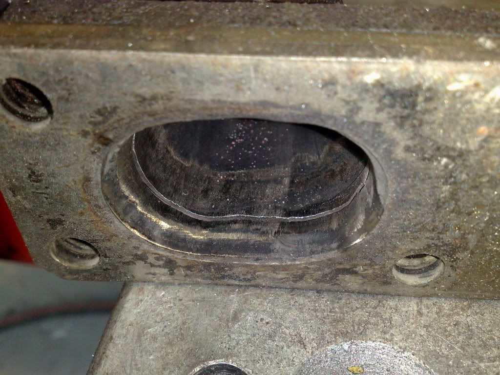

well iv had a good day on the compact today, manifold off and welded and back on and a z3 rack thrown in for good messure
a fair sized crack i would say, it seem also that its now got rid of my anoying flat spot too.
i welded around the inside were the crack is and around each header at the flang to avoid this again
