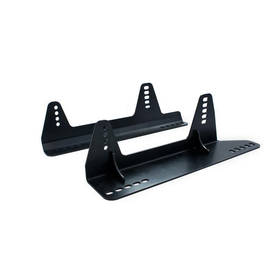

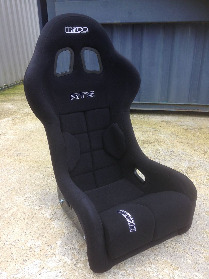

Postby davidc » Fri Aug 14, 2015 9:07 pm
Has anyone used the Cobra side mounts, they are offset to mount the seats central to the steering wheel & as close to the tunnel as possible, similar to a few on E-bay:
These are the seats that should be going in the car:
Cheers !
David
